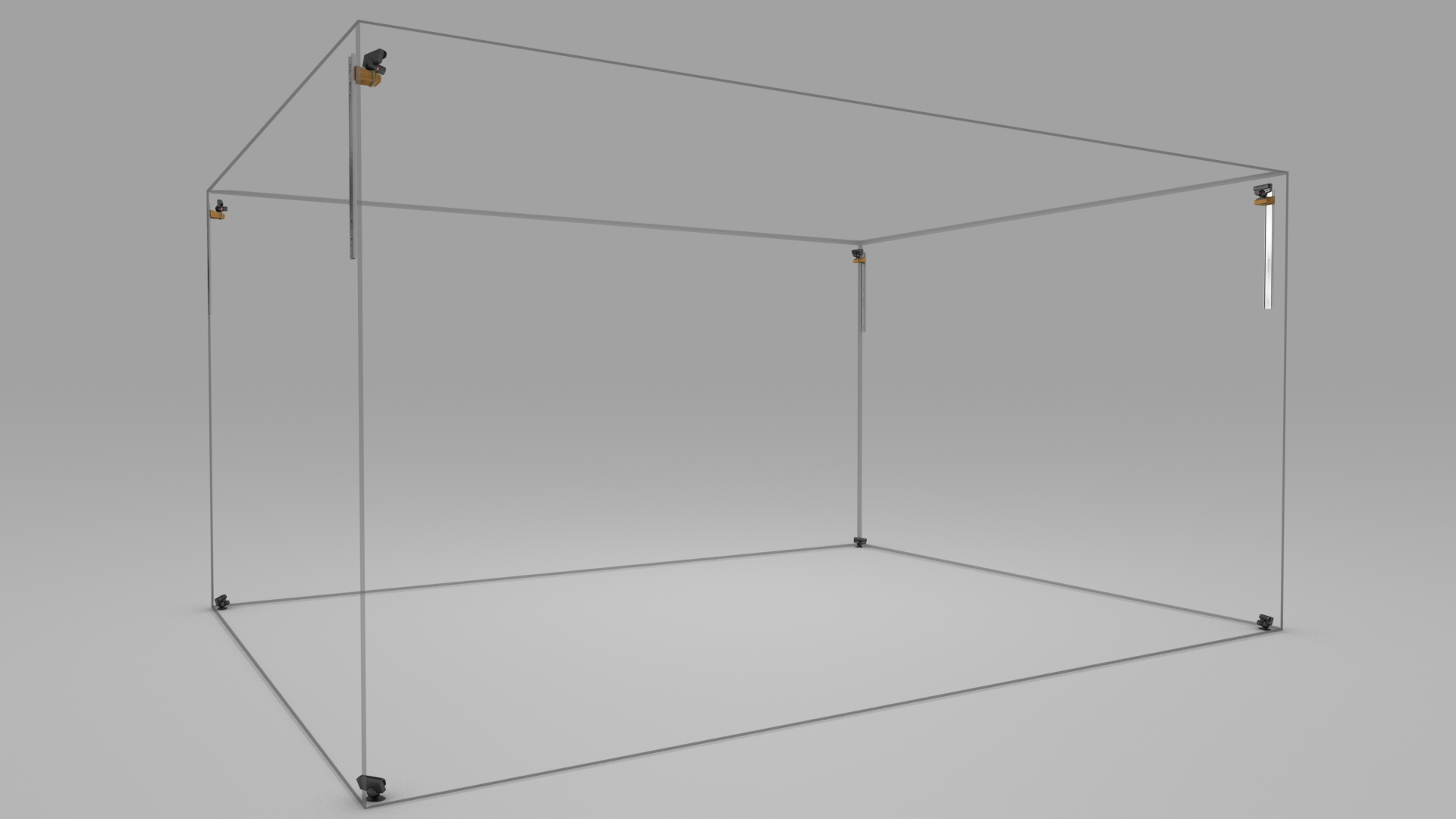

PostPosted: Mon Mar 31, 2014 9:56 am
Posts: 62
hi Vmaslov, well i used to record animations in even an smaller area, 2.6mx 1.9meters using 6 ps3 cams and everything was perfect. Now i changed to a bigger room and i will use 8 ps3 cams , the size of the room is exactly 4.53m x 3.42m, i havent calibrated and used yet , but i think it will be even better because i have 4 cams in one wall, camera 1 and camera 2 at the highest point each in one corner , and camera 3 and 4 sticked to the floor each in one corner of the wall. camera 5,6,7 and 8 are in the same placement but in the opposite wall(see pic attached) , so i think i will be able to use the entire room and not just a little area because when im standing near one wall , i will have 4 cams opposite to me and looking at me which are more than enoguh to capture the animation , and when i reach to the opposite wall , the other 4 cams will see me and capture my motions and i dont htink calibration will eb a problem , i hope not
