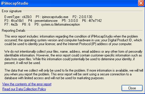

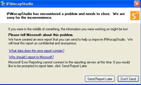

I'm getting this error

PostPosted: Tue Jun 05, 2012 3:44 am
OK, thanks.
When do you get this message? Immediately after launch of the application, or when you're trying to open some file (eg video/project) in Studio?

just after clicking on program icon.
Edit
I tried on another computer with xp and still no success.
