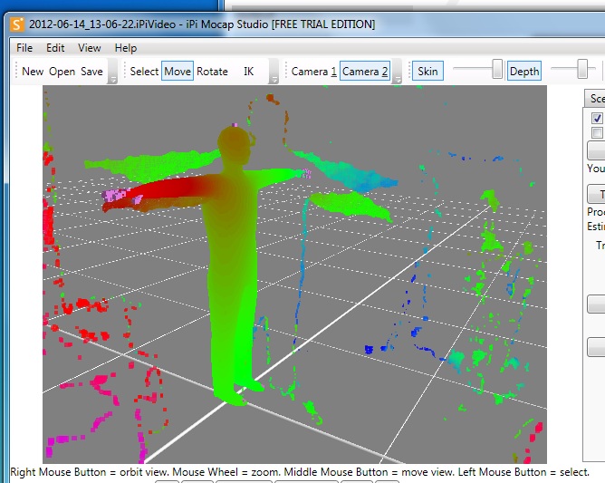

Hi I have a GeForce GT 340 and in initial tests with iPi2 I see a problem. In this image you can see my arms outstretched and there are two sets.where the two overlap you can see invisible nothing.
I have this problem with initial T-pose, because the data from 1 3d image of me overlaps with the other, the graphics glitch makes me almost completely invisible except a thin line around the edge of my shape. This makes it really difficult to align character in Tpose and due to not understanding the new iPi workflow the refit pose is senting actor into a small crumpled ball.
So this graphics clitch is a problem.
Another observation is that this is a cacophany of colour and everything being heavily saturated and bright doesn't help. Maybe I just dont get how to use V2.0. I await new tutorials eagerly.

Oh nevermind, it appears my recording missed the empty scene part at the beginning.
Please ignore/delete thread
PostPosted: Thu Jun 14, 2012 9:02 am
FYI, about background processing in v2. When recording with iPi Recorder 2 there is a separated stage for evaluating background, so there is no need for empty "background" region in the beginning of action video. When converting old AVI videos with iPi Recorder 2, background is evaluated during conversion from the specified region at the beginning of the video.
We won't ignore your post, because it points out to a background processing error, occuring under certain circumstances for newly created projects. We will fix it in next update of iPi Mocap Studio.

Fixed in release 2.0.0.133.
