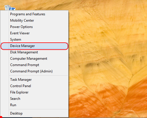

1. Right click on the left-bottom corner of desktop and in the context menu choose Device Manager item:

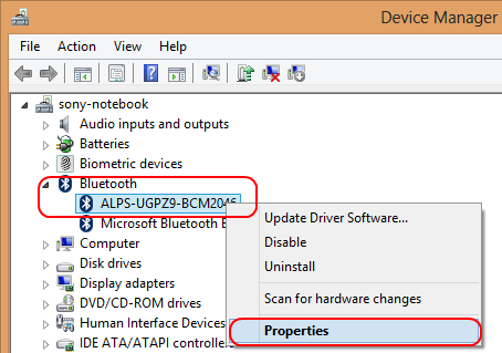

2. In the Device Manager select your bluetooth adapter, right click on it, choose Properties menu item:

4. Provide us with values which you'll obtain as a result (USB\VID_... strings)
