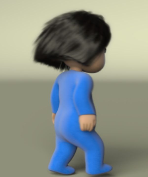

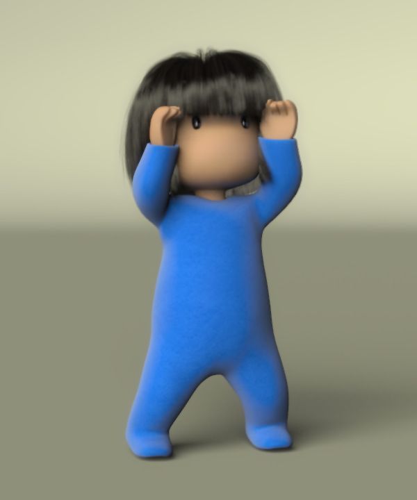

It's show and tell time! Here's 'Sister's motion test for the upcoming 'Brudders 2' short:
'Sister' Motion Test
For this test, we used two Kinect for Windows and two PS Move controllers for hand motions. We also tried out the new Hand Pose system recently introduced in iPi Mocap Studio 2.0 (2.3.0.147).
This completes our iPi Mocap Studio to LightWave motion capture workflow testing. The results seen this test aren't 'perfect' but it demonstrates that we now have a practical system for getting CA into our film quickly.
Now, maybe we can finish this darned thing! :)
Here are a couple of stills from the test:

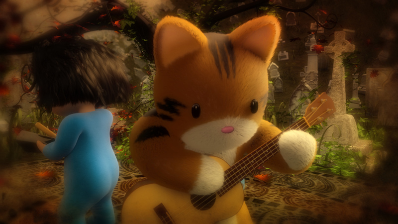

Here's another teaser image from our short film, currently in production:
The project has really picked up its pace lately and iPi Mocap Studio is working out beautifully.
Even so, I can't wait to finish this movie and move on to the next one. I can't believe that we started this project way back during the original iPi DMC 1.0 pre-release beta phase. Both my crazy cat movie and iPi Soft have sure come a long way since. :)
