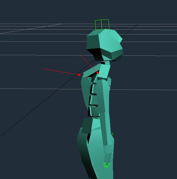

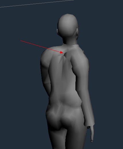

Shoulders are always twisted backwards
All are so caught
Have you encountered such a situation?

I did not do anything, the IPI shows normal
But matched to 3DSmax the "CS"
All simulations have this problem

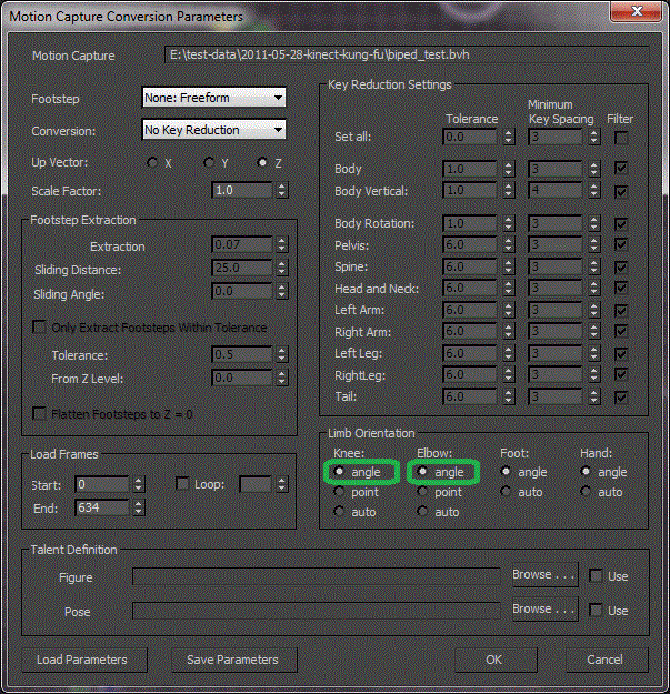

We investigated these issues.
I believe issue #2 is caused by incorrect import options in 3DS MAX. You should use "Limb Orientation: angle" instead of the default "point" for Knee and Elbow.

thanks for your reply. The issues 2 is solved just by doing what you advice which is to change the Knee and elbow limb orientation from point to ANGLE, thanks for that.
