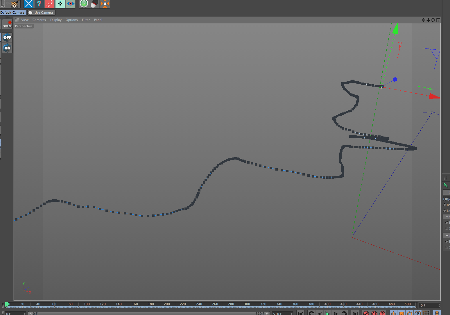

Hello,
I have a several successfully tracked takes that are applied to an FBX character and everything looks perfect in iPi Studio (V2). However, when exporting general FBX and importing into C4D, the character is extremely small and has a wild motion path attached to the first joint (hips - see attached). If I delete only the position data on that one joint, the rest of the character animation looks good, but it stays in one place. It's almost as if that large motion path is the actual movement in space, but the model is way to small in relation. Any help please?

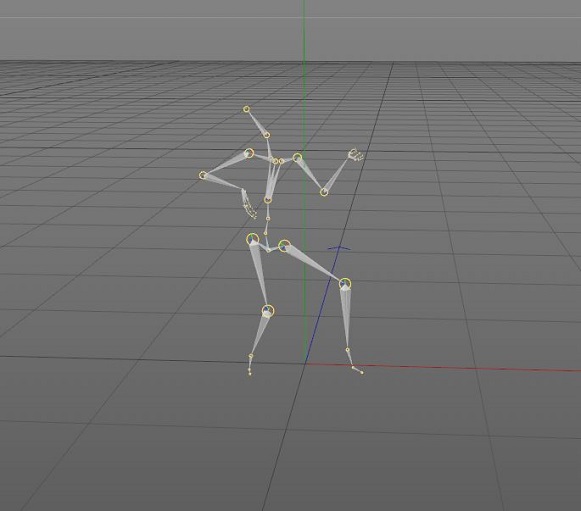

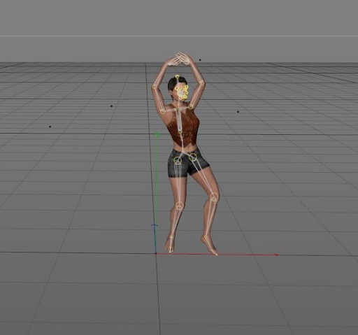

PostPosted: Thu Nov 10, 2016 9:40 pm
What version of C4D do you have installed? R18?
I just imported FBX files using file open command in R18 with default iPi skeleton rig and with an added target character mesh included and came in fine.
Tried using the merge command also and it merged another file in same project.
Check your project settings, project scale and you can change it if very small to make it larger.
These were exported from iPi Studio 3 though, so not sure about Studio v2, I would think should be similar, I no longer have any files for v2, or I would check and see myself.

I'm on R17 still. I'm attempting to export general/FBX with a mesh imported into iPi. Playback looks perfect in iPi, but upon importing to C4D, it's very small and attached to a wild motion path. I mean, the actual mesh animation looks correct, but it's zipping around on a large path. It looks like the scene is to scale, but the mesh doesn't match. I'd just map the bones to my mesh in C4d, but much easier to have iPi do that with character import/FBX export.
