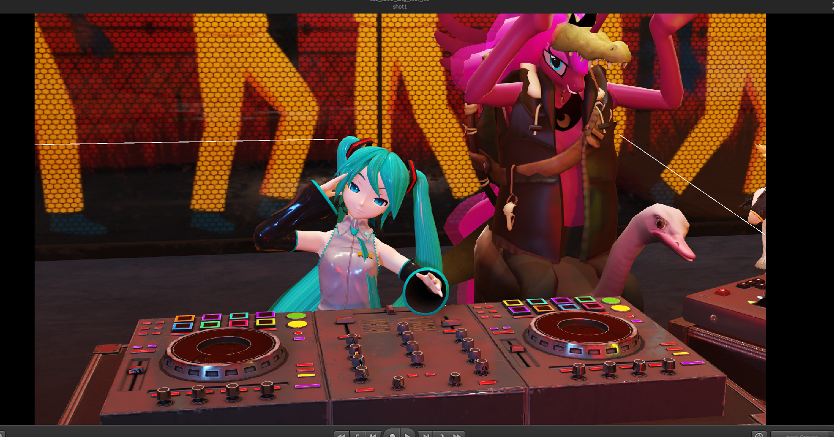

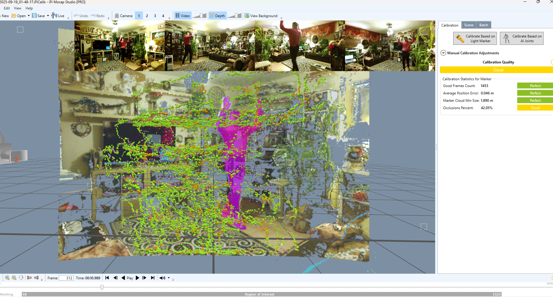

I must say I used that too it really awesome blowed my mind. I noticed I hate light calibration I always make mistakes because room not so good for it reflection take by cams of light make calibration gg and give me awful result but this method I using on my new up coming come sing with me at dj table make my mouth open :O
Its super easy its super fast its super effective corrective get all cam position awesome correcly even this room. only got OP score good all perfect nailed it.
