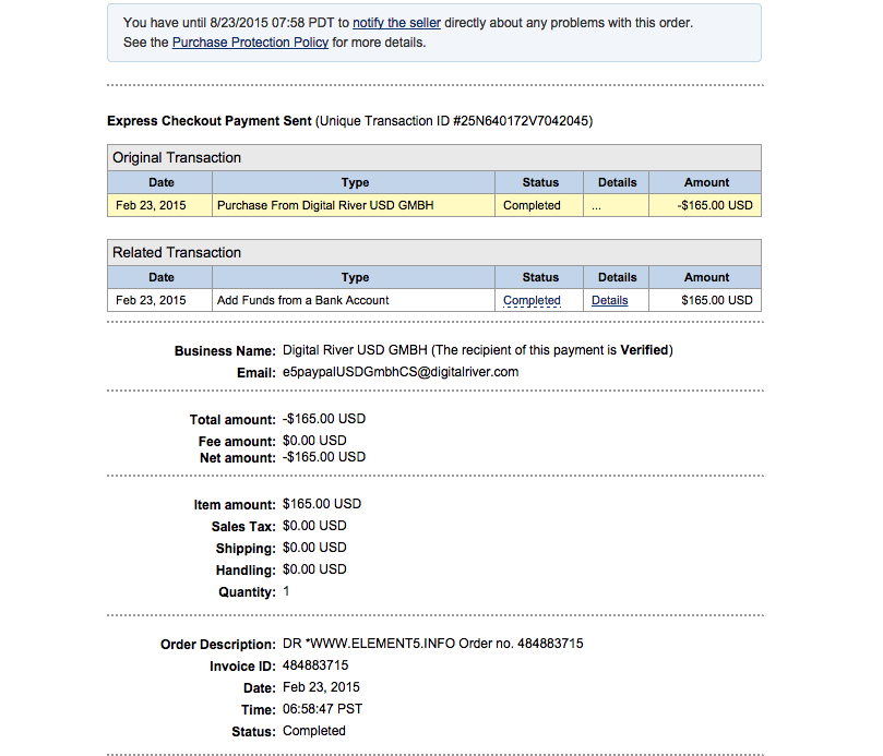

I used the basic version to create it. I purchased the 3 month version over a month ago. The file below is the saved action project I already tracked. For some reason, it is saved in a locked format (iPiLocked*). I also attached proof of my purchase.

I've converted the project file - see attachment.
Is this the only file which is in locked format, or the program does not allow you to save any new project in regular format?
