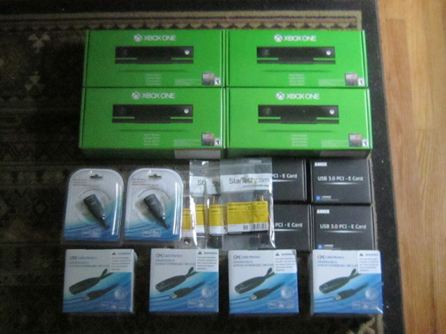

Wow, that was fast. The gear arrived Monday evening.
I might have time to install the cards tonight. Not sure when I can test yet...maybe this weekend.

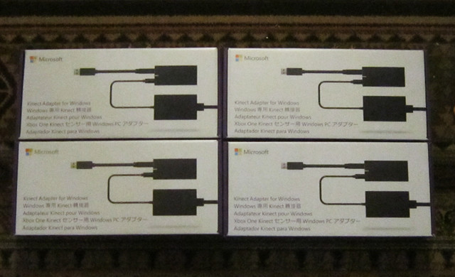

I thought I was missing something. These arrived yesterday.
Okay, so NOW I'm ready. :)
The cost per Kinect v2 compared to the old Kinect v1 for Windows is still pretty good but I forgot to mention that you need to include the cost of a PC adapter (about $50). This is still cheaper than what Kinect for Windows v1 with the bundled adapter cost (around $200 back when they were common) but getting four Kinect v2 devices at once might seem pricey (say, compared to multiple PS3 Eye cameras.) Considering all the points mentioned earlier, if it delivers on improved accuracy, I think will be worth it.
Will post another report sometime this weekend.
