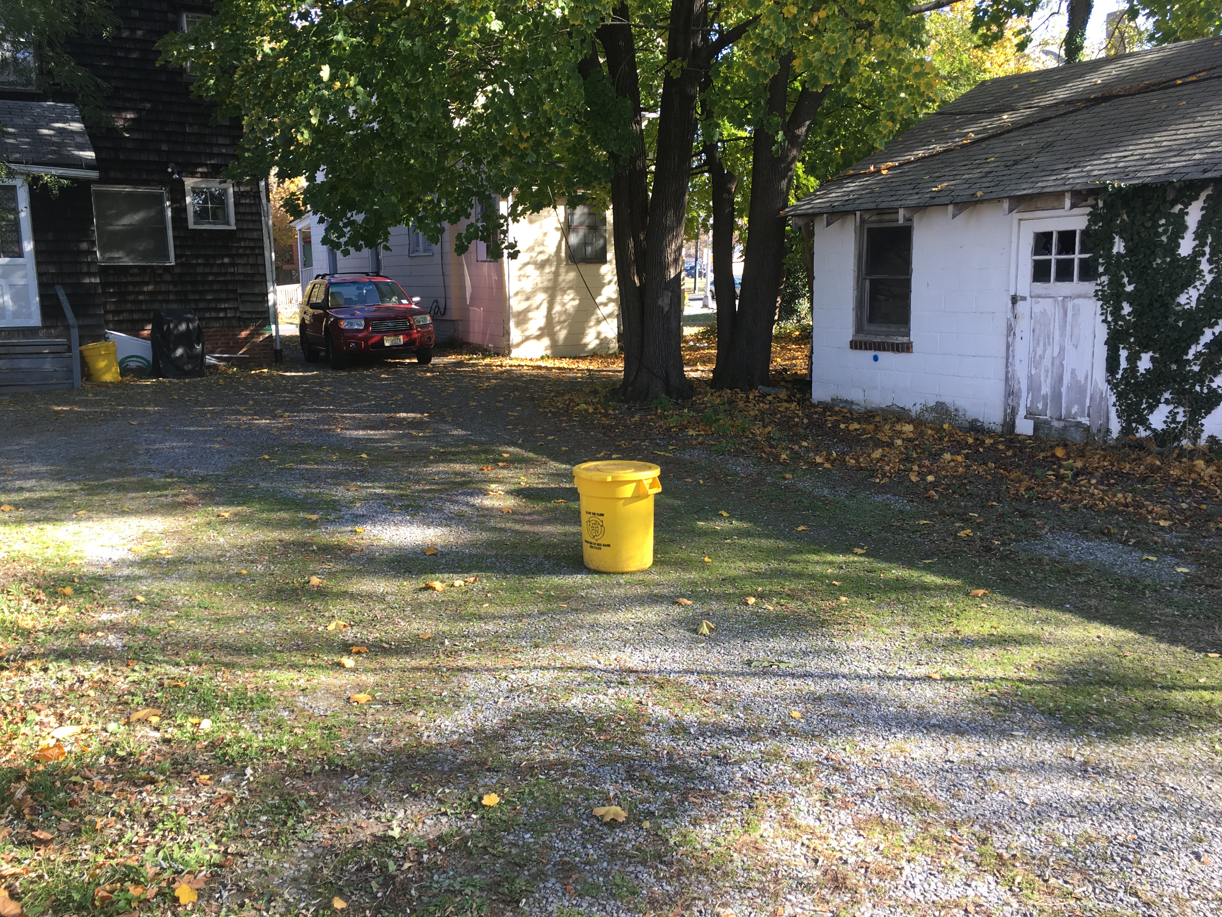

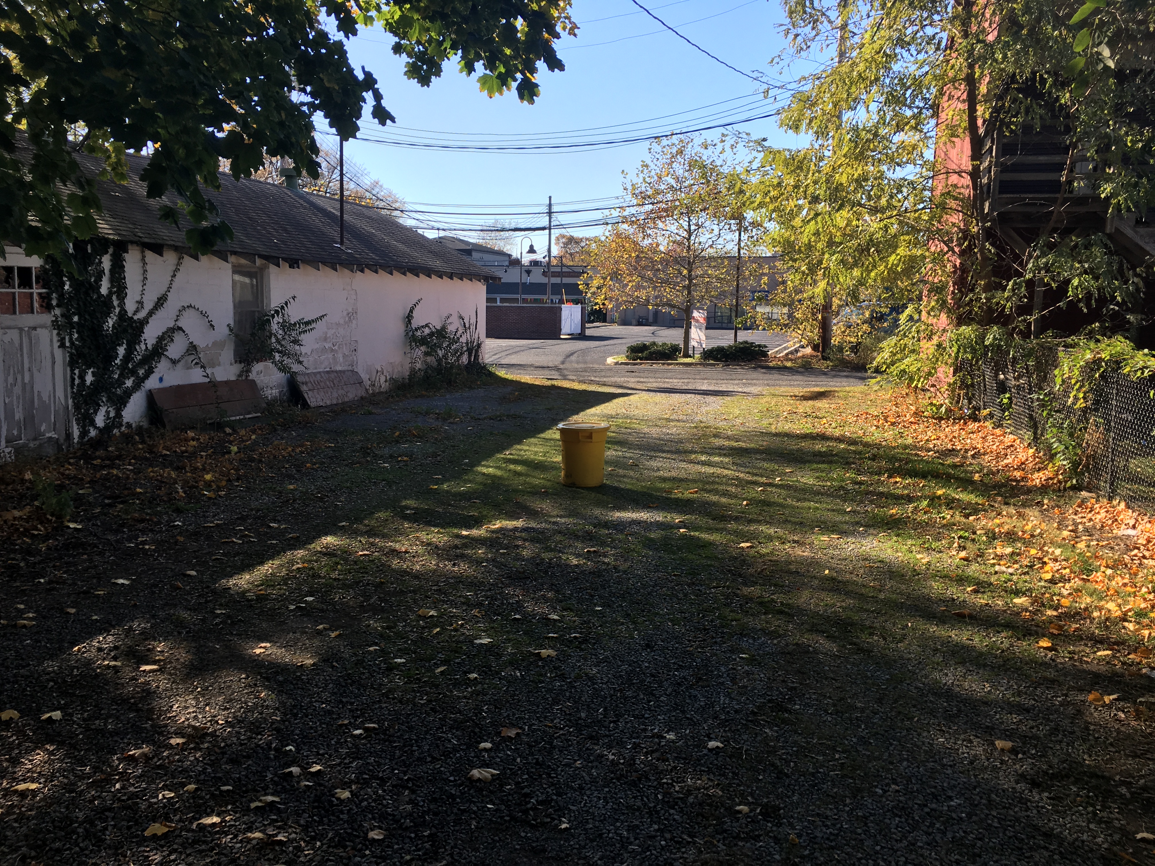

Before I do a 3D + photo assembly, I thought of a idea for stabilizing pvc piping.... what if there was no tripod but instead a pvc pipe as I have it (2" dia) was plugged into a storage pail of beach sand like this:
https://m.uline.com/h5/r/www.uline.com/ ... lsrc=aw.ds
It's a bit of a bitch to move multiple set ups of this (8 at least for me to feel comfortable). The reason I'm thinking about this is because I have some anxiety about plugging sharpened pvc pipes into some strangers earth; be it a park or whatever short of a private home with a lot of grassy and soft earth. I've attached a couple of screenshots of my backyard driveway. I want to potentially do this on property that I know will be ok. No additional spearing of the ground though it seems to work well if the ground was soft enough. My driveway isn't this. It's hard earth with a lot of rocks for driveway. I want to do this in 3D to paint a full picture if I'm not being clear or if even for my own reference. See attached photos. Imagine that the yellow garbage can is an actor or actors. Do you think this could work?

I am sure something like that would work, as long as it is deep as that 2 ft min, but dry sand will not pack well, my only thought and to dampen it would make it weigh a lot more to move, would just be a bitch to carry those around for a portable setup, but not to bad if just sitting in your own yard.
I still think you will need at least one brace off the top, be it made of whatever, to stop the top of the pipe from chattering, but give it ago without bracing and post your results.

Pretty nice area where the pics were taken, fair amount of shade it looks like which is good, if that's the area you plan to set up in, but what really matters is what the cameras see, so turning down the exposure to 60, or below and the gain to below 16 may help, a little grain in the recording won't really affect the tracking, just avoid massive grain in the footage.

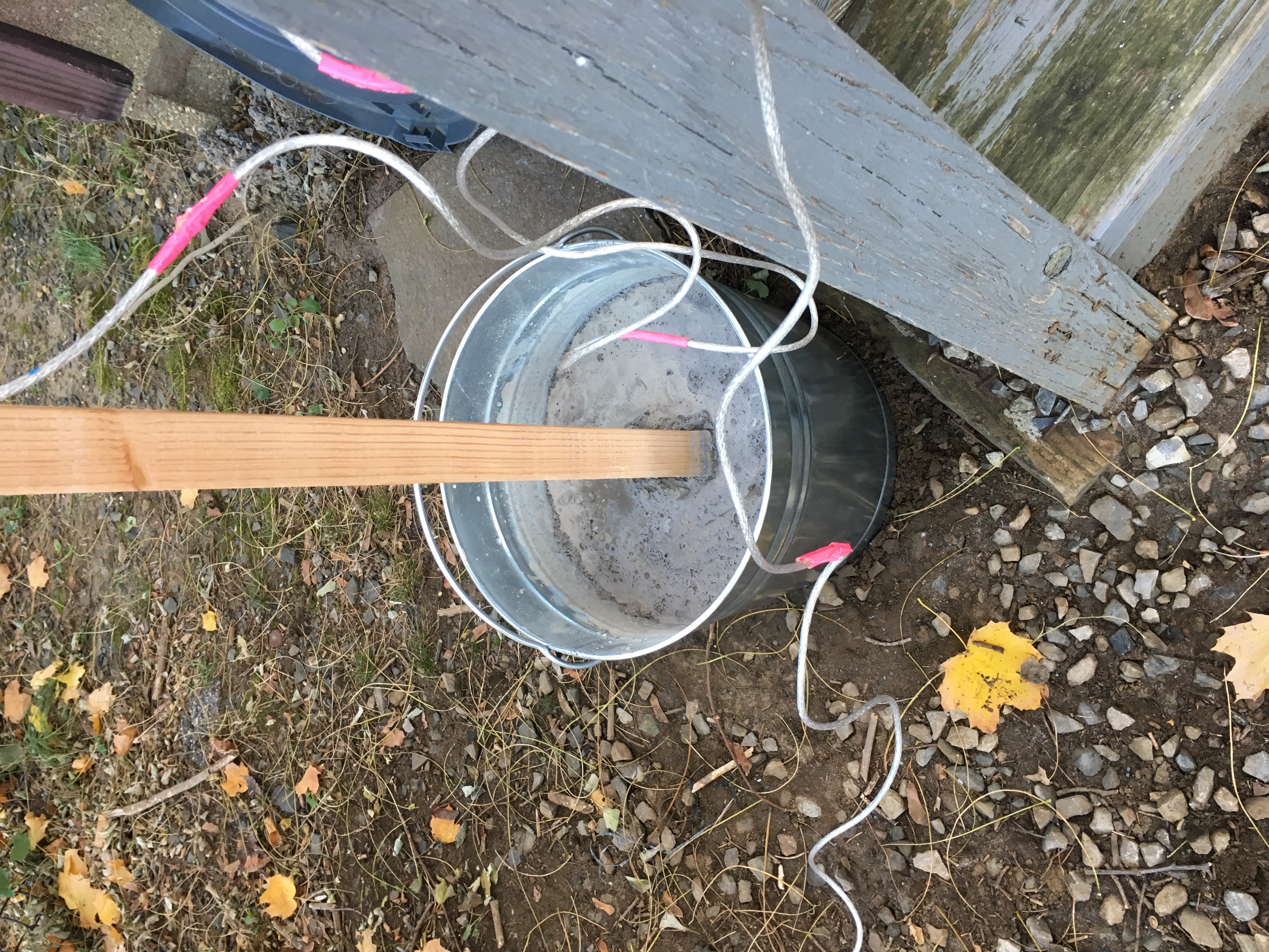

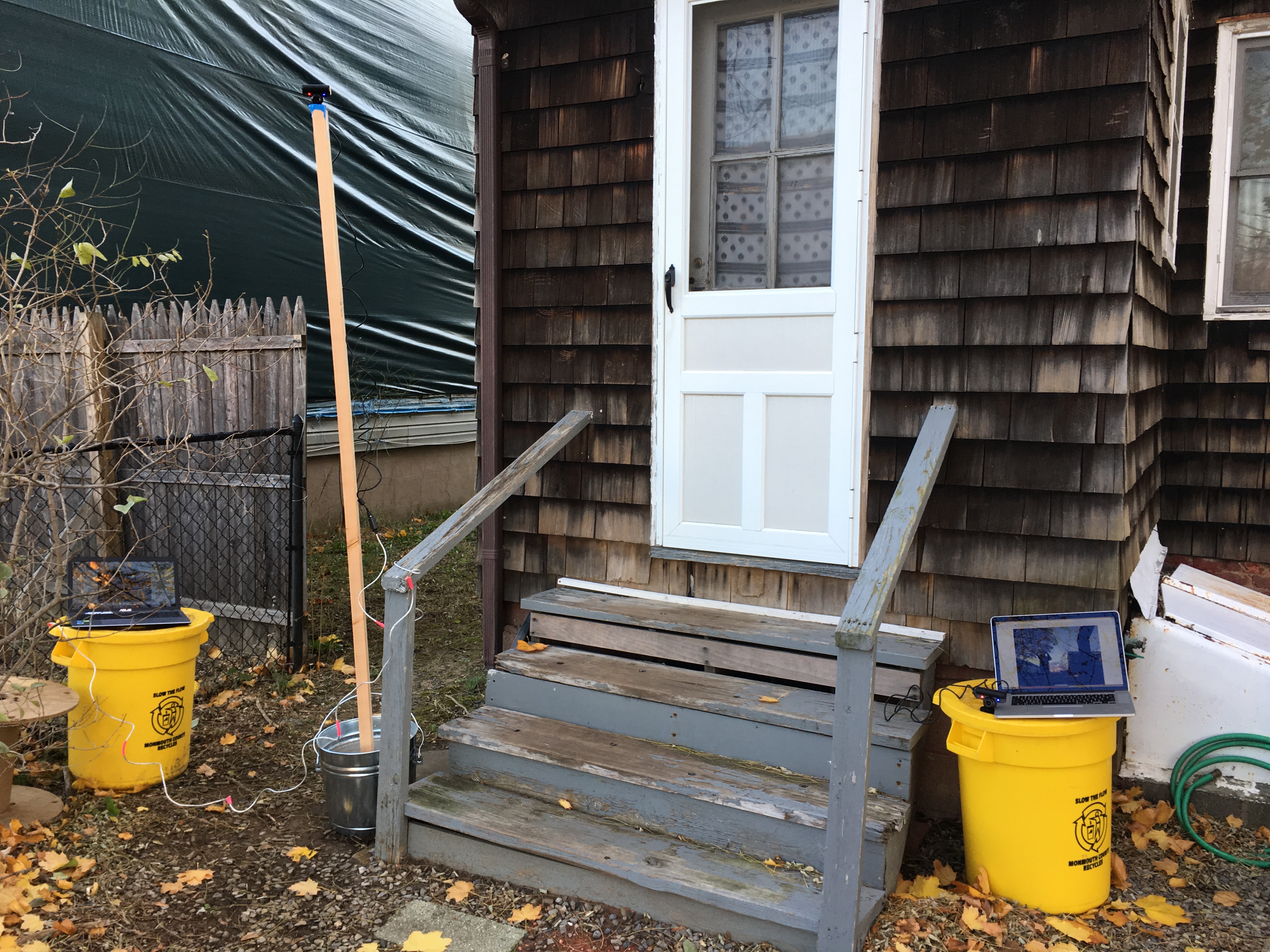

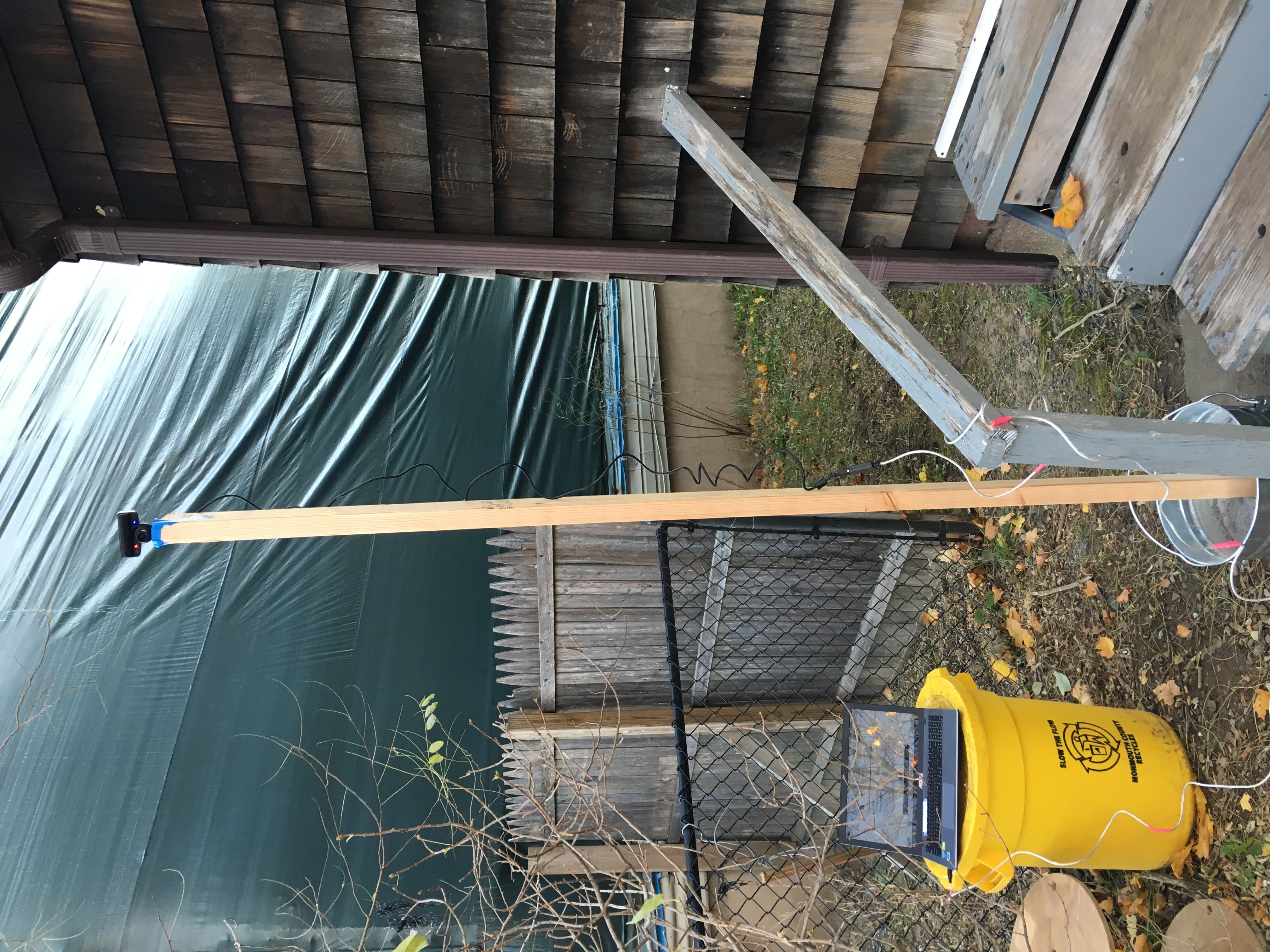

There wasn't enough wind this morning to know if it'll hold up in it, but this is what I made yesterday and just tried a distributed recording using my iPhone as a hotspot. I forgot that I needed. At least 3 cameras for this to bring into the studio, but the real test was the bucket. It's a an 8ft tall 2x4 supported by QuickCrete (red bag). 50 lbs. it hardens quick. Heavy as hell but that's kind of the point. Last night there was some wind and, only if I touched the 2x4 was there chatter. Otherwise, I think this is going to work great:). See photos attached
