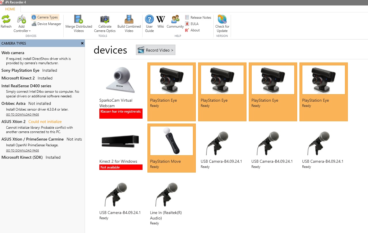

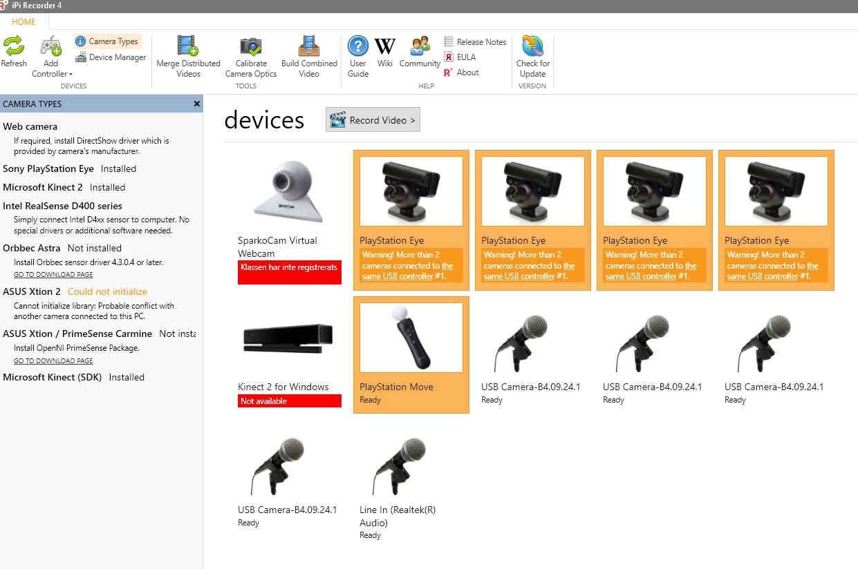

this is when startup ip recorder
4 pc3 cams via usb 3 controller connected 2 cams rear and 2 cams front:
This is after calibrating:

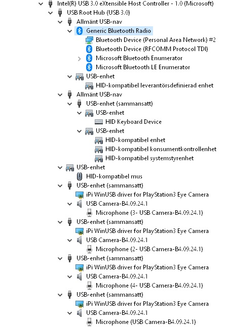

and her is from device:
So Im a Little bit confused: Why does ip recorder warn at startup first time but not after calibration ?

That's normal due to mobo's sharing the 2.0 and 3.0 controllers from the ports used.
That warning will return if you click the refresh icon on top left of the ribbon.
As long as any cameras attached show the video in the view port and all maintain running at 59.5 to 60 fps continually you should be ok.
(It seems you are in Europe, so maybe your on 50 Hz power and can only run cams at 50 fps, I am not sure about that though, maybe iPi can clarify that).
For some reason now, the red warning status info pops up a lot more now, more often due to background warning, than frame rate, so be sure you maintain proper background lighting to help avoid this, but as long as frame rate remains steady is the main thing.
