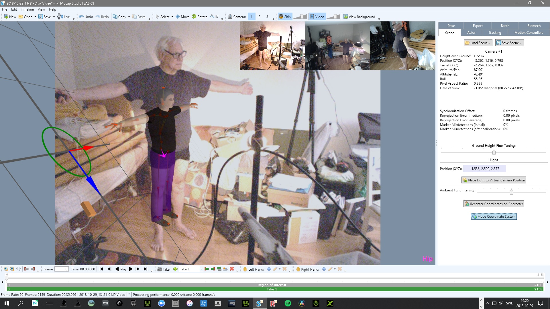

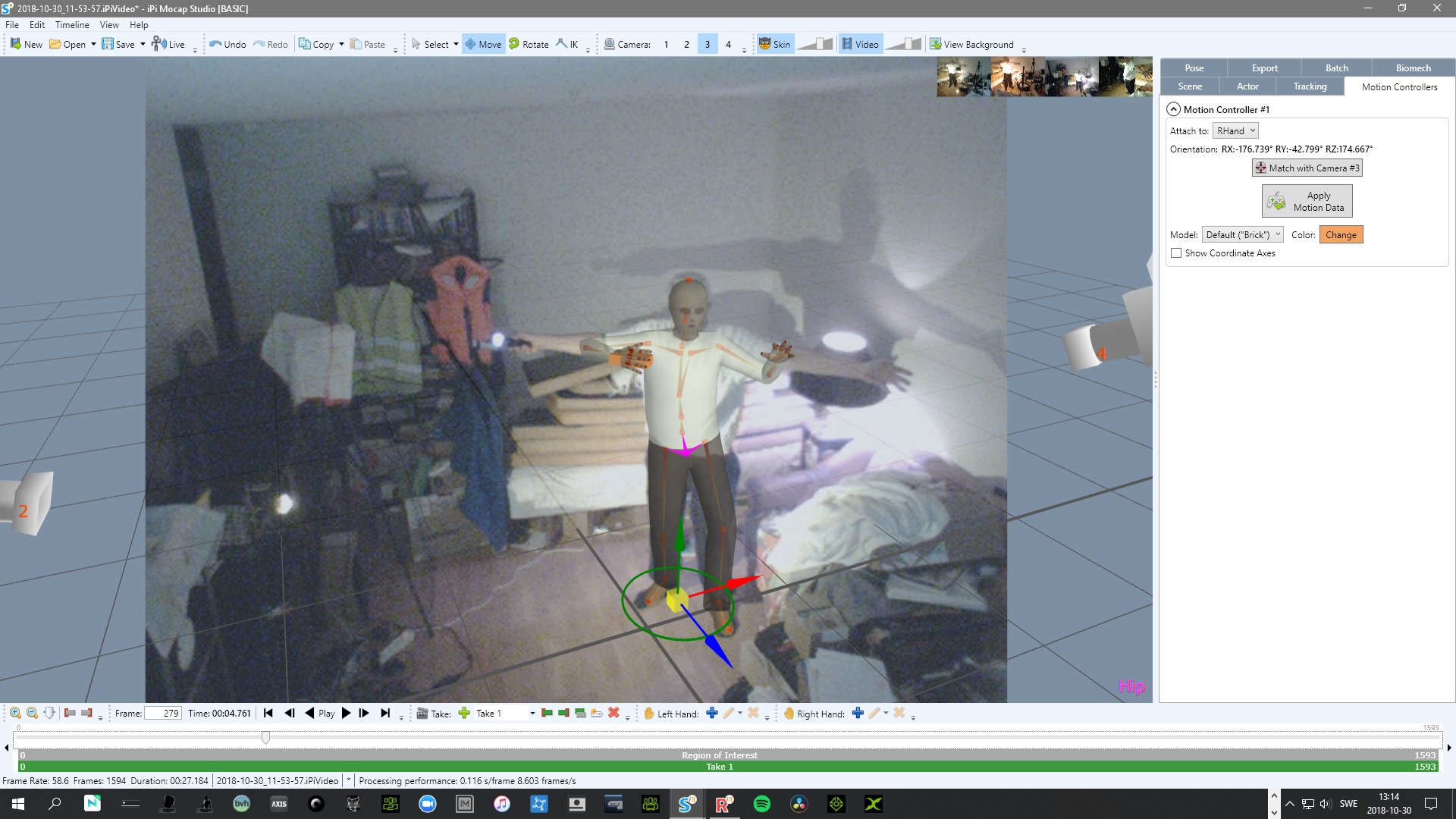

Well i selected the move cord. but i cannot align i to the floor in the video... look :
 Post subject: Re: Setting up ps3 mover
PostPosted: Mon Oct 29, 2018 8:33 am
Looks to me like the entire calibration file is either the wrong one for the video, or wasn't done right from the beginning, you MUST set the camera 1 height off floor to the actual camera 1 real world height by measurement in meters.
At any rate, that cal file is incorrect and must be redone, if the cameras haven't been moved since the video was recorded, you can just re-record the light marker and re-detect it with the proper settings for Cam 1 height and you can not have a high level of misdetects in your calibration, or it will fail, even if it shows as perfect, but it shouldn't if things aren't close to right after running the calibration process.
There is also no way possible to have tracking work properly with wearing shorts, you MUST wear long pants and appropriate contrasting colors to the background.
You may want to better familiarize yourself with the Docs on PS Eyes usage, they are completely different than that of Kinect.

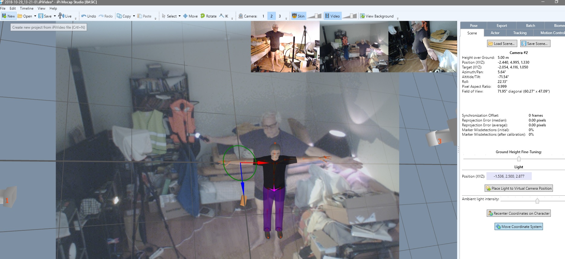

well, the day starts rather good. I look at greenlaw:s tutorial with calibration 4 ps cams in a Little area. I tried to do exactly and i suppose I was lucky with the calibration… but as Always as a newbee there are a lot off problems during the Project:
In the Picture I tried to psn the actoar to fit myself and it starts good, but when i started to move my hands i had this failure:

Thankyou Snapz !
Today i had luck with my animation with 4 ps cams and 3 movers. The character almost followed me. I made a little calibration area and calibration showed green for all cameras and the right positions regarding space between cam 1 and cam 2 and also heigth of cam 1.
But you are right.. in this Little calibrated area almost 1.5 x 1.5 M with four markers on the floor i can do a 360 deg turn on the same place :-) ...so i need of course more space esp now when i got six cams.
But i se a difference vs Kinect v2 namely tha charctaers hands are shaking a Little bit to much after the jittering process.
And it takes very long time until the char fits in position. Ive tried at least 15 times until he stayed there. As I moved the char in one cam to fit it didnt fit in Another cam and so on... so im a Little confused how to fix positions ? I suppose that i have to stand in the middle of every cam..

To the jittery hand issue of previous poster, the PS Eye full processing path must include the running of the "Refine" process, either forward, or backward for the entire ROI you are tracking and the Move data must be applied always as the final step, before playback review, or export of the animation.
This process should also be run even with Kinect v2 tracking for best results, but many leave it out, as it takes extra time to run it, though it is much faster with Kinects.
PS Eyes are more of a Prosumer set up, things should be much more tightly respected, as far as the room, lighting, clothing, space, colors of all corresponding parameters, just much more consistently followed, not just a plug-n-play set up as easy as Kinects, and even if all parameters are followed the calibration must be very good and the iPi Actor set up correctly, but once this is all realized it is an excellent solution for mocap, and I would put my animations up against any other budget solution available now, though it isn't a real-time solution, but in my personal experience far less clean up in the exported animations than most real-time solutions, especially now with v4, for standard sized human figures anyway, it gets a bit tricky to act as if you were a non-standard character, but not impossible, if you know in advance what character you are performing for.
Of course not all users want to put in the time to get good results, they would rather get an instant recorded export and spend hours upon hours cleaning it up, more power to them, but I handle 90% of this right inside iPi Studio very quickly before export, especially since the recent updates to fix the upper arm twist issue, but of course you have to know what to look for and how to fix it to do this efficiently, and I at least know my motions are very close to what was performed, because I am tracking and can see the actual video reference while running it through.
Until you really satisfy all the necessary parameters to run a PS Eye set up efficiently, you are just going to be disappointed in the results, that is why I believe you would be better off with dual Kinect v2, even though it takes a compatible 2nd laptop to run a second sensor, but even that set up has its limitations.
If your calibration is well done, you should really only need to align the iPi Actor in one camera, usually camera 1, or the best viewing camera anyway, then on refit it will snap into proper position in all cameras, if it doesn't, then the calibration is off, even if you got the notorious "Perfect Green" showing.
It is very hard for someone else to explain, so it is really just a trial by error until you figure it out to get the best tracking results you can with a PS Eyes set up and some users just have better luck than others.
With the new tracking algorithm, it is much more accurate and full tracking loss should be at a minimum with PS Eyes, so if it isn't, there is something not quite right that you will need to track down and fix, that's just how it is, or you can use another solution for mocap and deal with a whole different set of specifications for its performance.
