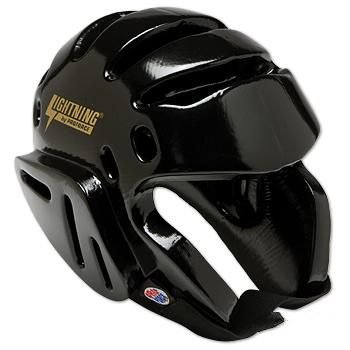

This is info for other users who wish to use a head rig with PS Move. Mine is mounted on a $6 hard hat using a small padded riser and heavy duty Velcro. The tricky part was finding a secure but comfortable strap for the helmet that allowed me to open my jaw. When I finally found one, it cost as much as the helmet. Still, not a bad deal.
The helmet is very steady and I've been using it successfully for about 3 1/2 years now. Here are two short articles I wrote about it featuring pics:
http://littlegreendog.com/?s=mocap+helmet
The original version with the bike helmet worked well too but I needed to use it as a bike helmet. :P
Recently, I noticed that the strap on the hard hat is starting to wear out so I'm thinking of upgrading to a sports head gear. Here's what I'm looking at now:
They go for around $15 to $20. At first I thought the 'shininess' might be an issue but maybe not since the motion is actually recorded by the Move controller. I'll post a new article once I do something with this.
