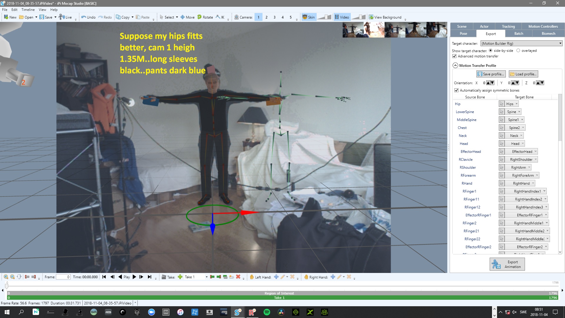

Thankyo Snapz ! I couldnt wait to Clean up in my extra room because i was so eager to test the cam 1 high just to fit my hips and i also find a black taiht sleeve, my pants are black blue and the sleeve are black.

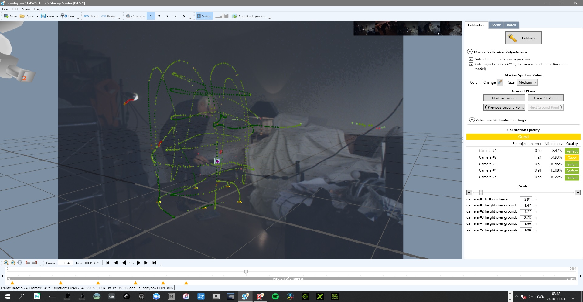

In Picture one i calibrated a Little area and did manually floor markets but when a corr the cam 1 real high 1.35 M it didnt fit soo god so i didnt change the cam1 heigh at all.
Mounting the cameras may require attaching them directly to the walls with an L bracket of some sort, but they need to be attached securely, or at least to the top of a single pole stand that will reach higher, tripods can work, but not the best option for your space.
If I were to set up cameras in that space, I would change the layout to run with the length of the room, placing the front camera as far forward as possible @ 1.20-1.30 m, then 2 cameras on each side wall, about 18 inches ahead of the front cam at 2.00-2.30 m, (you need to fit the entire usable floor space, as well as the top of your head in all cameras, full arm raised extensions may not be fully possible in your space though), then 2 cameras slightly behind your center floor mark @ 2.45 m, and the 6th camera somewhere up front @ 2.45 m looking down on you for better feet tracking, a rear camera really isn't needed, nor really possible in your space.
It can be set up catty-cornered as it is, if need be, but still follow the same camera placement and heights as above, but this still won't accommodate a rear cam by seeing your space in the images, it is being blocked from viewing the floor by the bed, or whatever that is behind you.
You can flip any cameras upside-down to get a bit more height if needed and set the camera to the upside-down parameter in camera settings just for those cameras.
You are getting closer, but remember PS Eyes do not like bright light shining into their lenses and you will need some sort of dimmer lighting behind you off to each side, or those cameras will appear too dark and you really can't crank the gain up to brighten them, or it will most likely cause erratic frame drops when recording, gain should never be set above 20 on any camera if possible.
This system works best when all cameras can see a similar image brightness and clothing color, too much shadows, or color variation will affect the tracking.
It does take more attention to these details for best results and following them consistently for each recording session, I can't stress that enough.
Once you get it and understand it though, you will have it and it will be second nature to run it this way and it won't seem so complicated.
No one should really go by my results, especially not starting out, I am just suggesting better reference points, I have a completely different area than most do and I have been running this system for years now, but I will say version 4 has made it better and easier, and less tracking loss issues for me anyway, though depending on the motions it still may throw a few at me, but I know how to catch them and correct them on the fly for better end results.

Yes, that looks better on scale, I still think the upper legs top joint should be lowered to where your crease bend of your actual thigh is, right now it is up near your actual top of hip bone, that is not how character weighting is usually set up and the exported skeleton should match a character, iPi Actors hips too high will cause the feet to want to leave the floor on bending actions at the hips, or on outstretched leg motions... Look at the Pose Tab to see how the skeleton should appear in the scene on your body.
One camera looks very much brighter than the others, check to see all cams are pretty much equal in their settings, then a trick is to turn the auto gain OFF-ON (let cam fully self adjust for each camera)-OFF again, then leave it OFF on all cameras, and leave settings alone after that and the gain will remain more steady during recording, you should be able to use the default settings for each cam @ 120 gain and 20 exposure for now, if too dark at those settings, then you need to add more lighting.
Looks like with your helmet so big, the color caught the part that was uncovered and not the black, you can manually change the is the Actor Tab under appearance and use slider to black, or color picker to choose head black.
Room area is getting better, covering clutter will help, keep playing with things until you get a desired tracking result for some simple motions, then work your way up more advanced motions and see if tracking remains consistent... You may loose connection during tracking at some points, just stop the tracking and realign it at the point of occurrence, hit refit again and carry on, many times just a simple last good frame start and re-track will fix it, sometimes not, use the < key to move back frames easier.

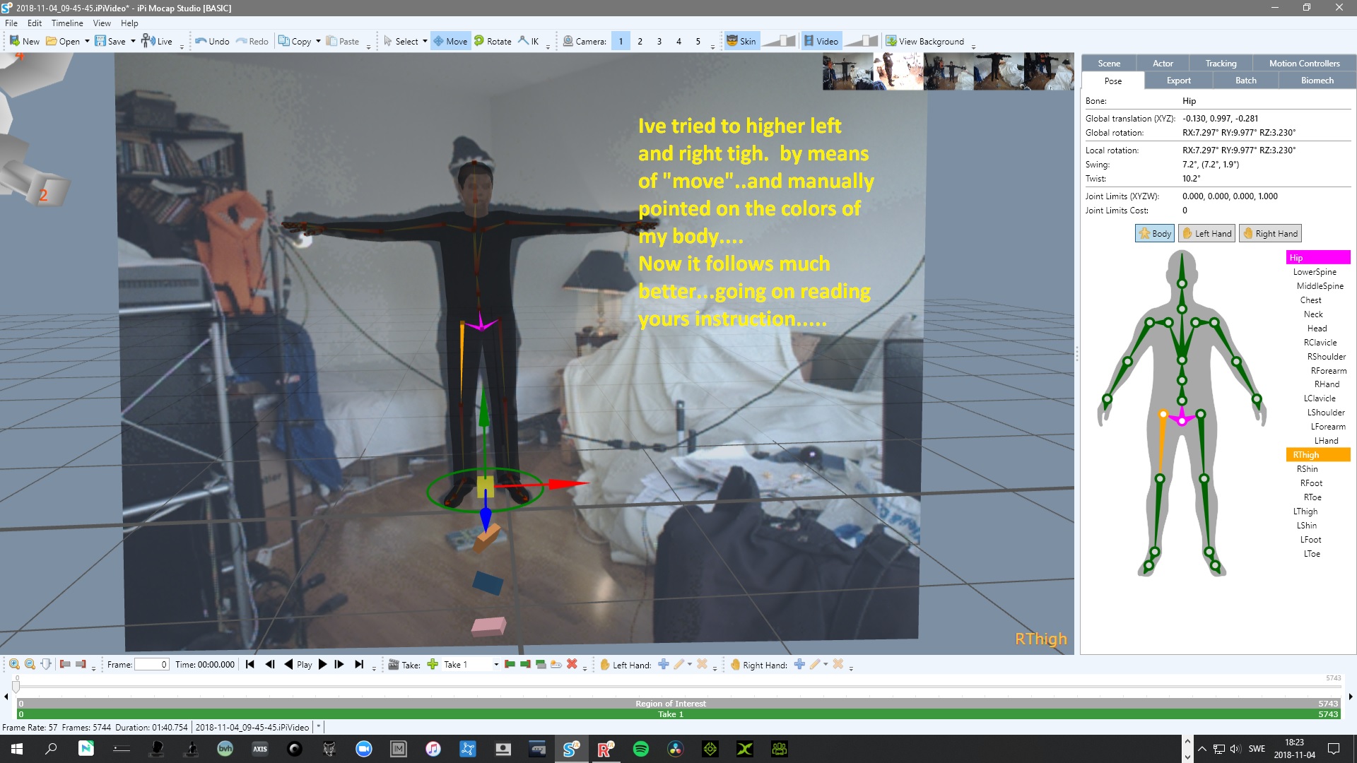

Ive tried to high left high and right high, but im unsure if i may do it with the "move" or scale...and im a also a Little unsure where my left and right tigh is in my body..i will try to figure out…
Quote:
Yes i did manually by the pointer and thats changed it all eg my hair is now black beacause i pointed on the black area on my covered helmett. And after that...just a big differense in the tracking process...it follows much better….so i will go on reading yours instructions and I be back...
best regards funwithps3

You don't use the Move tool to adjust the hips position, use only the Actor legs bone scaler, then hit refit again, adjust more if necessary and hit refit until in proper location on the video, you will also have to adjust the arms length in unison to match, but once have it, Save that Actor parameters to file.
Thigh bone top joint of the iPi skeleton should fall close to the crease in your body between the hips and middle thighs, this is the bend point of almost any human 3D character and the only way iPi will track properly, or you will experience leg, hip and feet issues.
I am not sure you are tracking with head ON, but without it ON can also cause tracking issues with many other bones.
Using the Stiff spine setting can also cause some issues with PS Eyes tracking, so best to right now just use the Flex setting.

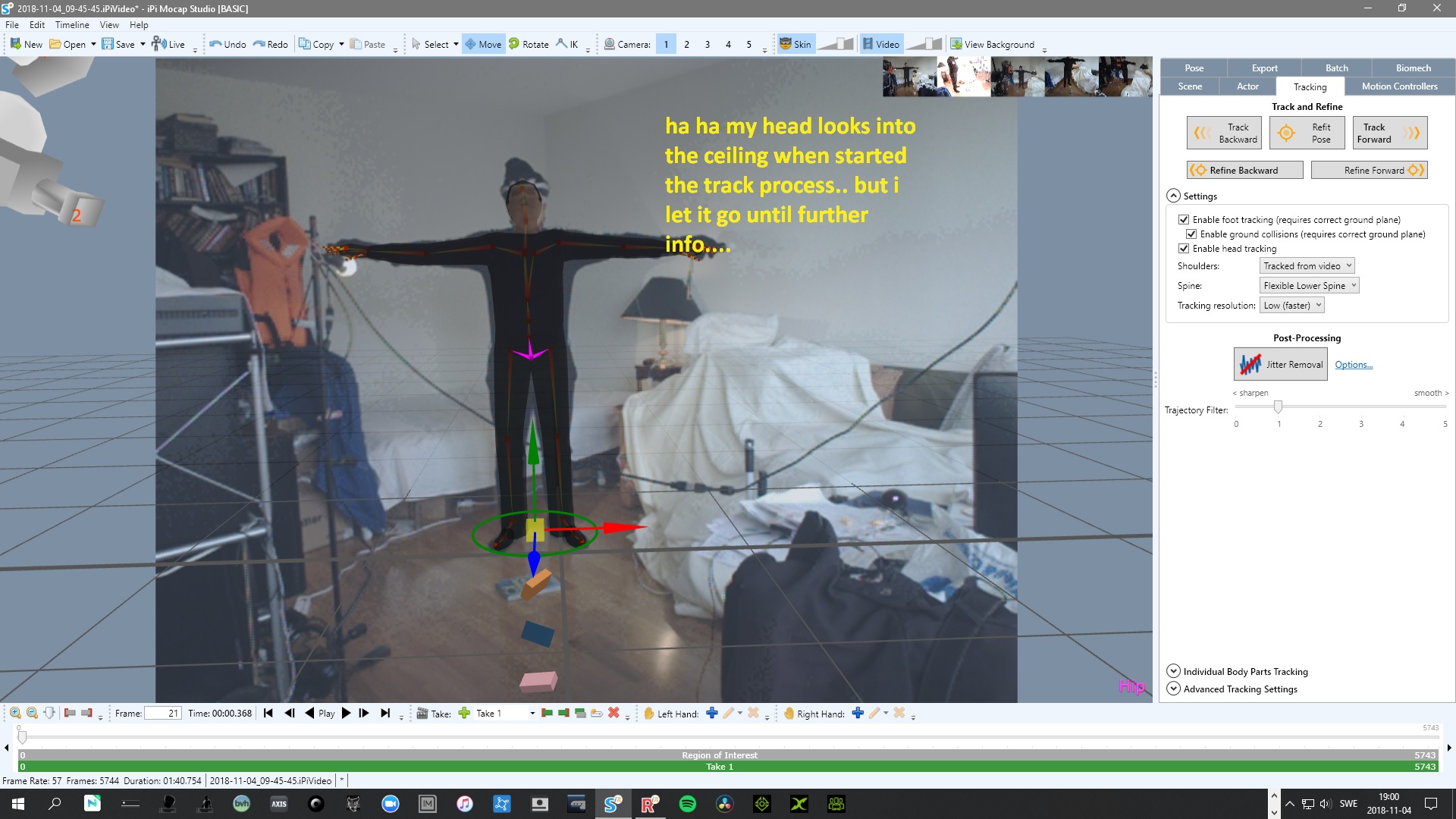

Head is looking up because it is trying to reach the black color, but the helmet area the head is on is whitish, so pull the hat to cover the whole helmet next time.
I would really suggest a better head device to hold the Move, but for now it is what you have, you can probably just pull the knit cap down snug right over the Move on your head and it will stay in place fairly well for testing purposes, as long as it doesn't move around under the cap while performing, which it shouldn't if cap is tight enough and look for a better head mount, or at least paint that helmet a darker color, darker colors work better than lighter colors with iPi.
