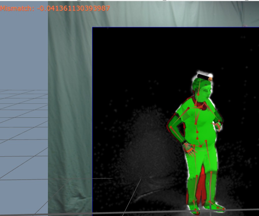

Hello everyone,
I tried hard to decrease the value of Mismatch. But the shape and the thickness of thigh and calf is unadjustable. How can I further decrease the value of Mismatch ? See my picture.
PostPosted: Tue Mar 12, 2019 12:51 am
An actor can wear not so tight pants to better match the model in Mocap Studio. However, to me your mismatch picture looks good enough. Tracking algorithm chooses a pose with optimal mismatch value anyway.
