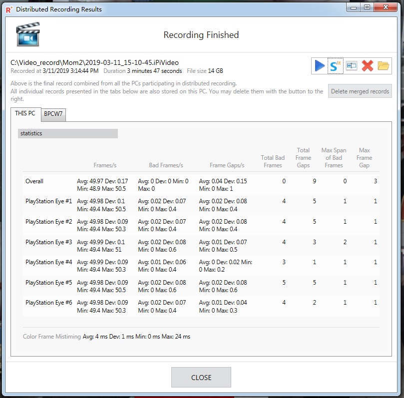

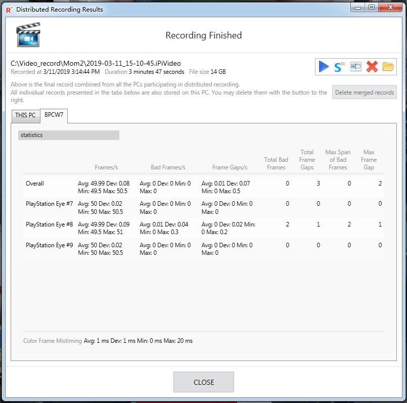

I got some bad frames and Frame gaps frequently, was it normal? I could not wipe out all the bad frames completely.
Please see my attachement.

Of course, clean statistics looks better :) But having ~1 bad frame per minute of recording won't make you any real trouble.
Probably that indicates you've got some performance problems. E.g. CPU load during recording is close to full.
PostPosted: Tue Mar 12, 2019 9:14 am
You must be using 50 fps camera setting, per screen shots, so if all cams maintain 49 fps, or better constantly, a frame drop here and there won't noticeably affect tracking, but all cams plugged in and in use during recording MUST maintain consistency in fps, or you will experience issues in tracking results.
