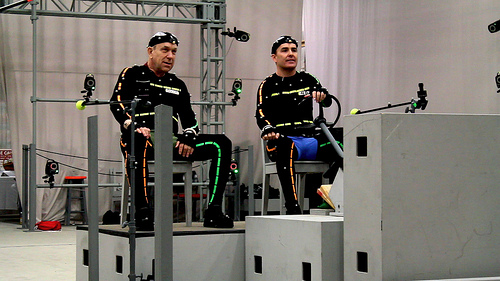

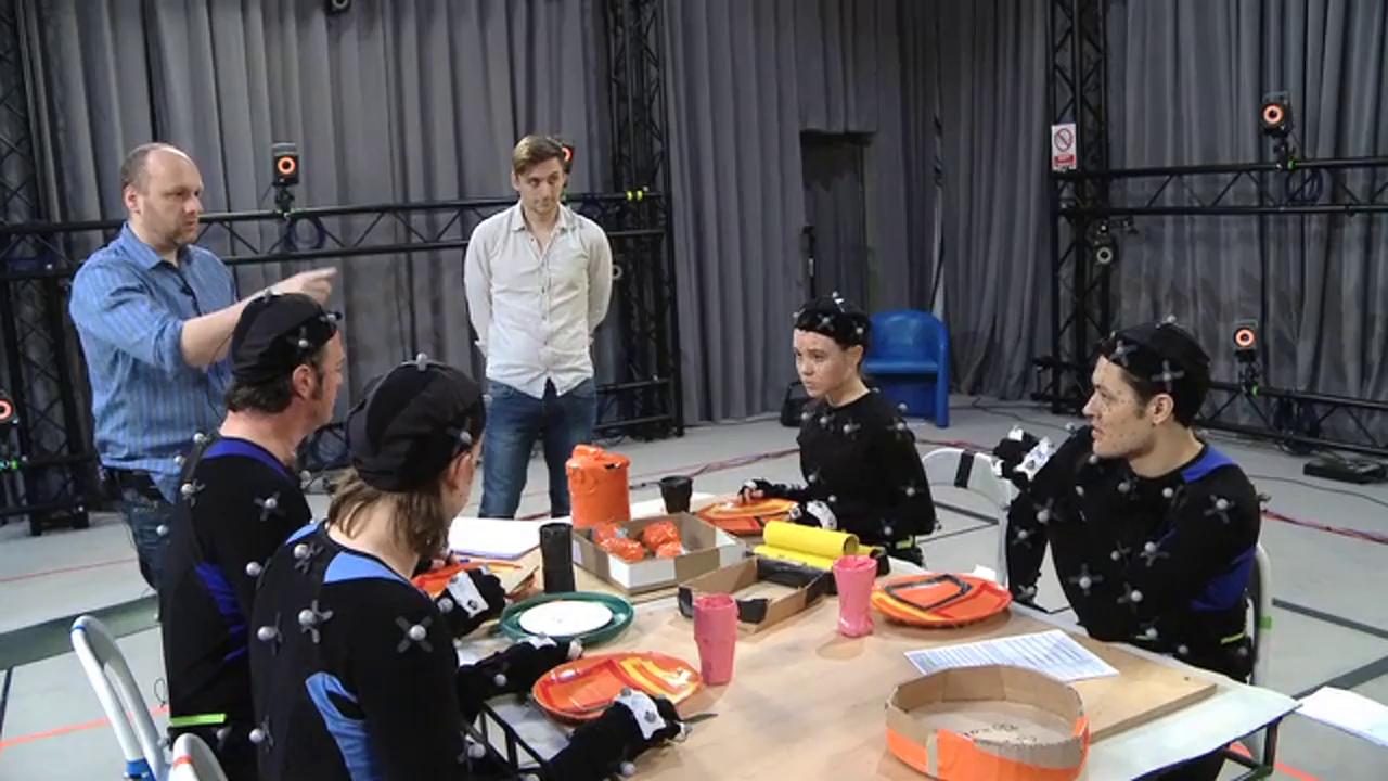

wondering if anyone has mocapped not only actors but actors that are engaging the environment they're acting in. Things like opening doors, leaning against walls, sitting in the driver seat of a car. I'm looking back over production of some video games by Naughty Dog and Quantic Dream to see that they have a lot of hollow-ness and basic props in their sets. Wondering if anyone out there has had experience recording while taking into account the "world interaction" aspect of making DIY props. Part of me is feeling like I should get familiar with PVC plumbing parts, but not sure how far I need to go if recording with deliberate references to the world can be made without making a bunch of stuff that I'd rather not.
Anyone got a sample of acting against a wall? Opening a door? A door a can see faking to a degree but not the stability of leaning against a wall. Since we're all here without suits, wondering if there's a method to hat I should approach in recording.
As luck would have it, where i live, there's a chain linked fence between my home and our neighbor. It's hollow. Recording an actor leaning against that might work well....if the bastard didn't flex so much.

You are correct, you have to try to use the smallest barrier between you and the cameras, so do they that you showed in the images, but with that high end system they will always get better results.
PVC structuring I have found to work very well and I have mounted flat surfaces to the tops of tripods for counters, bookshelves and bar tops, really anything you need to act like was a solid topped surface, but it's not an actual solid structure, so you have to work with it accordingly.
As long as you have 3 or more cameras that can see the full actor to maintain the triangulation needed, you can lean your lower back against a more solid lower object like a desk and then use some upper body improvisation to get the effect, you can also set up the cameras for a specific shot to include more areas of the performer as needed, but I wouldn't worry with all that, just adjust the performances and structures used in scene.
Seated at a table like shown is a bit different when recording with iPi than that type markered system, as you can not remove bones being tracked with iPi, you would just have to remove all the legs and below data later in an external editor, in a sense, freezing the lower body below the hips, but that could cause other issues that would need manual clean up.
