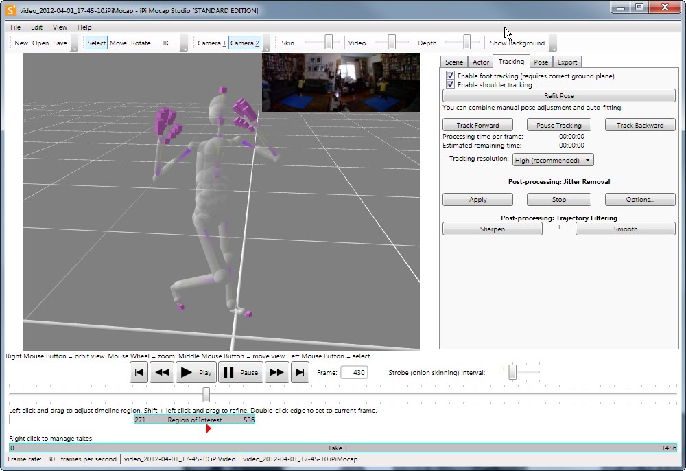

Here's the screencap from iPi Studio 2.0 you requested. To enable Collision view, look under View and select Collision Objects. As you can see in the image, this collision objects represent the volume of the limbs, not the bones inside the limbs. Hope this is what you were looking for.
BTW, I'm glad you got me thinking about this. Enabling Collision Objects view might help me analyze and understand what's going on with the '3 Happy Cats' motion a little better and help me improve future capture sessions. After all the time I've used this software, it never occurred to me how useful this feature could be in some situations.

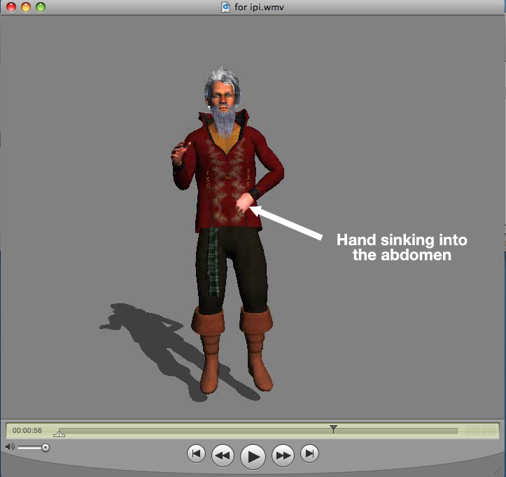

When I speak of 'collosion detection' I speak of most commonly hands going through the body - see my example attached from natofor's recent clip.
Again...hope you peeps don't mind me using your pics as examples.
Greenlaw....so you're saying version 2 has sorted this out?

No, I'm basically just saying iPi 1.0 and 2.0 already has some form of self-collision build in, but It's probably meant to prevent more egregious penetration issues and not as sensitive to smaller items, like the hands in your posted example.
Maybe it would help if they allowed the user to configure self-collision sensitivity for limbs like they have for jitter removal. In your case, you could use more self-collision sensitivity with the hands, and in my case I could use less in the legs and feet.
Just curious but are you using Kinect? Hands can be a little trickier with Kinect because the volume can get a little 'blobby' when the hands are close to the chest and stomach. When we do our performances we try to be a little more conscious about bringing hands too close to the body.
This doesn't directly apply to your character but with the 'Happy Box' mocap we had penetration through the head because our characters have such huge heads. In Motion Builder, this sort of thing is very easy to fix:
1. create an animation layer,
2. keyframe the hand at a peak position before and after the point of penetration,
3. go to the point of penetration and move the wrist joint to the desired position and keyframe it,
4. hold that corrective position for as long as needed.
If you're using a control rig in your animation program, it should be just as easy to correct. This is a common problem, especially for characters that have non-human proportions. It would be cool if iPi DMC can get similar post-retargeting editing features someday.
