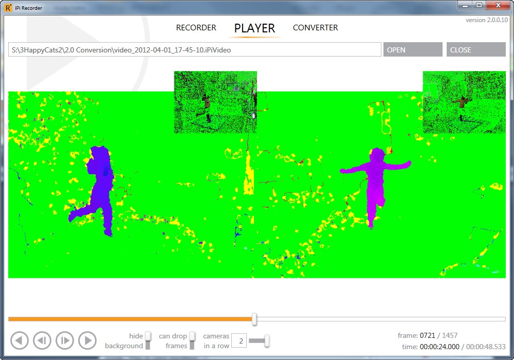

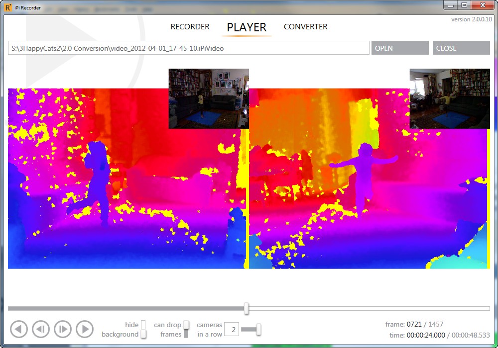

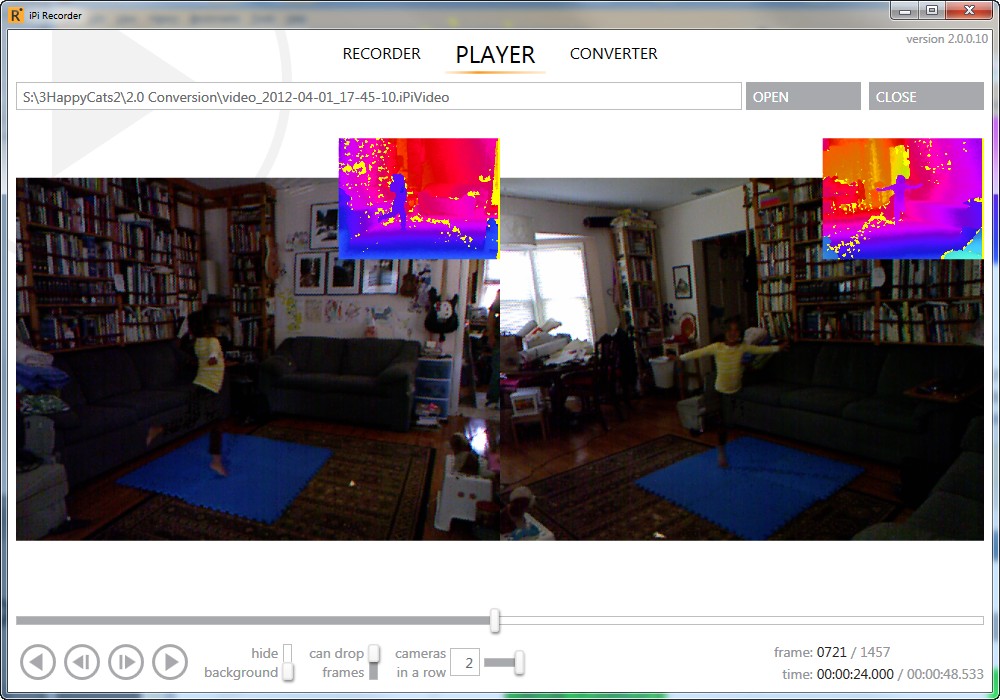

After converting several files, I viewed them in Recorder's new Player mode. The depth video look much nicer--the new colors make the depth range clearer than how the same data was depicted in iPi Studio 1.0. (I haven't seen at this looks in Studio 2.0 yet...will do so soon.) I love the various layout options and switches in Recorder 2.0, and the 'Hide Background' option is very useful for isolating and analyzing the quality of data during a shoot. This should make it easier to determine if a re-shoot is necessary long before getting the data into iPi Studio and tracking it. Kudos, guys!
File comment: iPi Recorder 2.0's new Player mode.
File comment: Depth data as it appears in Recorder 2.0.
File comment: Hide Background mode in Recorder.
