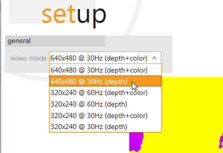

Turning off RGB recording is made via selecting depth-only video mode on the Setup stage. Changing screen layout in screen controls affects only displayed data, not recorded.
Please note that video modes list on screenshot is for ASUS Xtion, but list for Kinect is similar (it also contains depth+color and depth modes).
File comment: Video mode selection

Many thanks for fast reply. Works a treat.
