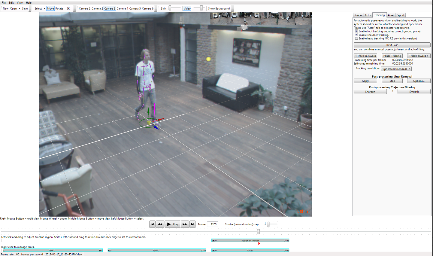

id like to know if there is something like best color combination of cloths for mocap purposes.
Currently im trying combination of grey slim trousers, blue shoes, black long-sleeve shirt with white t-shirt over it.
But sometimes i got problems with hand and foot tracking, so im curious if there are some better combinations you using for that.
Thanks for advice.
File comment: sample of my mocap

White t-shirt is not a good idea. Shadows are very visible on white and the system cannot model them (since it is very hard to model all lights).
You can have better results with blue or green or magenta or cyan t-shirt.
The same logic applies to shoes.
