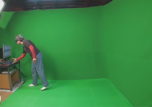

I use similar foam mats on our small shooting stage--they're almost the same color as our green screen and they work great. Here's a picture of what it looks like:

We purchased ours from this vendor: http://wondermat.com/
I've never tested white but my guess is that white probably isn't the best choice with either PS3 Eye or Kinect--with PS3 Eye, white may show shadows more easily which could affect background separation quality, and with Kinect the brightness of the surface may affect the IR quality. I could be wrong though.
On other hand, if the lighting in the room isn't very bright to begin with, the bounce on white may be helpful to even out the lighting on the subject. I suggest that before you make your purchase, you could try spreading one or two white sheets on the floor and see how that affects your mocap experience.
Sorry, I hope that didn't just complicate your decision making. :)
For me, the two reasons I got my mat was to extend the green screen across the floor and to give performers a comfortable surface to work on. For the purpose of motion capture, it's not especially necessary. (Unless you plan to fall down a lot--which I do, and sometimes on purpose even.) :)

Lighting is currently not an issue, as we have access to several large pro studio lighting rigs. I think I should assume at this point that any color should work fine, assuming the volume/subjects are brightly lit and floor color is not similar to the actors clothing. That's more or less the methodology behind chromakeying as your picture demonstrated.
I think I am leaning towards white, that way any color spill caused by the floor will not dilute the colors or change color values on the subject based on volume location. As a plus white should give good bounce back up onto the subject.

Exactly! BTW, a completely featureless background isn't necessarily ideal either because background detail can be used to calculate the ground plane and camera positions. That said, the stage above worked well when I used it for iPi mocap. (FYI, I still have the stage setup for green screen work but nowadays I do most of the motion capture in the home using dual Kinect.)

The mat tiles are great! They have a matte finish so they don't bounce IR and they're really comfortable to perform on, especially if performers are jumping, tumbling, etc.
What you want to avoid is shiny surfaces, like polished tile or wood. Reflections will confuse PS3 Eye camera data and can misdirect IR emissions from the Kinect sensor. Our house has wooden floors, which is not good for iPi at all, but luckily we have a large rug covering most of the living room floor.
You may also want to avoid exceptionally bright light or surfaces that are too black.
