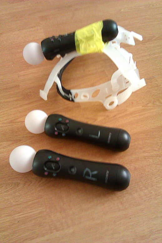

Attached is a picture of my makeshift head controller 'device', made from the inside of a hardhat and it works perfectly as the straps are adjustable. Only cost me £4 from a local shop.
Oh, and I used a chinagraph pencil to label the hand controllers L and R, in case you have to put them down and you get them mixed up. That may not be necessary to the software, but I did it anyway.

Yes, marking the devices is a good idea--I have mine marked similarly. This is especially convenient when you're recording in a different room because you won't have to keep checking to see which device belongs to which hand, and it will prevent any confusion during tracking.
