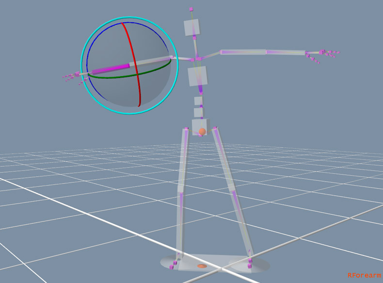

The x-axis (red) rotation can not be tracked by the record video
PostPosted: Sun Apr 28, 2013 9:25 am
The red rotation shouldn't rotate very much since it's basically the 'roll' for the forearm. If it's not rotating enough for your capture, you may need to adjust the shoulder, as described above, and retrack through the error.
If the issue is that the elbow won't bend in the direction you want, that's definitely a shoulder issue--make the adjustment upstream and retrack.
If the issue is palm orientation, that's mainly adjusted downstream at the wrist not elbow.
PostPosted: Wed May 01, 2013 6:54 am
This exact rotation (roll of lower arm) cannot be tracked by optical or depth sensors, because arm's image is very similar in different roll angles. Especially when it's covered by sleeve (usual case).
What we can do is to track wrist orientation (affected by lower arm's roll) with motion controller. Though we apply captured roll orientation to the wrist bone itself rather than to lower arm bone. This is not correct from the view of human's anatomy, but is more convenient for application to 3D models to avoid skin distortion of a model.
