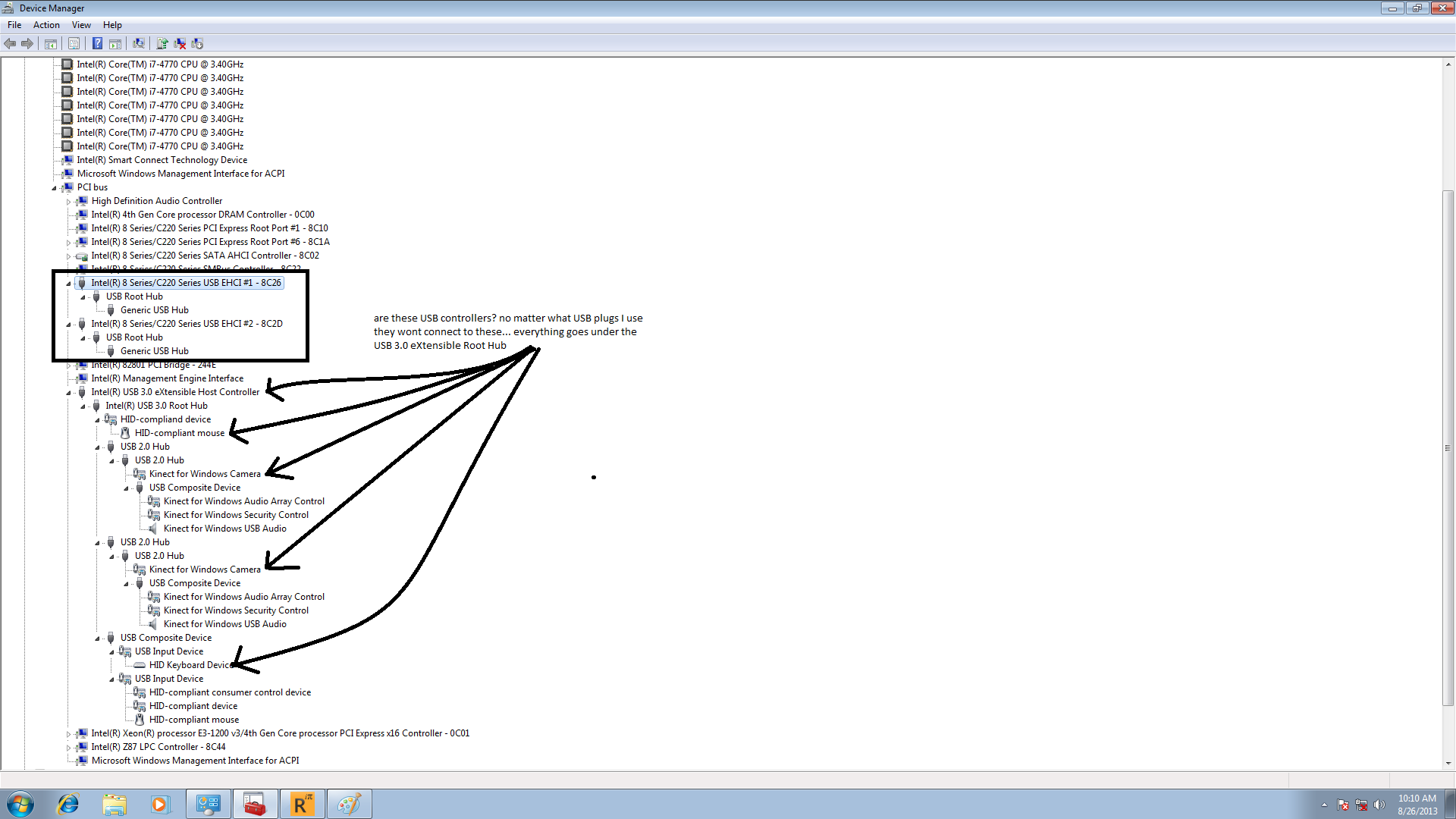

Attached is a screen shot of my device manager again...
I still cant get anything (mouse, keyboard, kinect) to connect to the Intel C220 USB EHCI #1 and #2
Are those USB controllers?
I dont want to have to turn off the video and reduce the resolution. I bought this computer specific for shooting/tracking animations.
Thanks again for all the help. I hope we can sort this out :(
 Post subject: Re: Dual Kinect Issues
PostPosted: Mon Aug 26, 2013 11:46 pm
Posts: 466
Hm. May be this question can be addressed to computer manufacture and/or seller? Why all USB ports are connected to one and the same USB 3.0 controller meanwhile two USB 2.0 controllers are not in play? Probably, it's a bug in internals cord connections?
