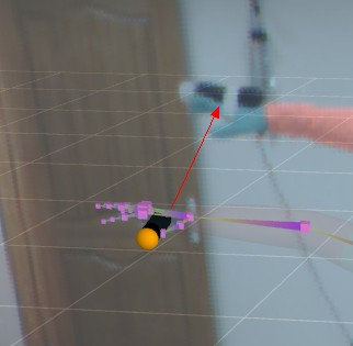

why

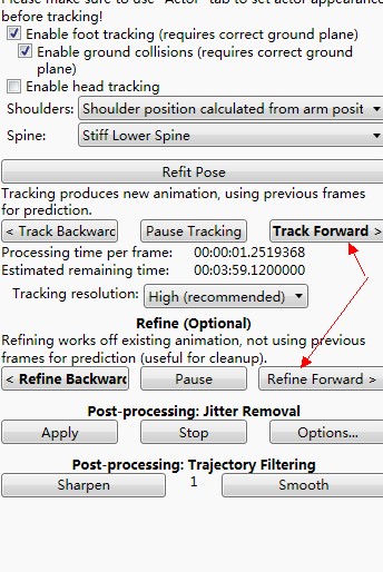

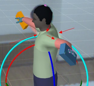

Upper body is always twisted
This has nothing to do with PSMOVE
Often this is so, what changes
You can send us the project (with video) in which you are experiencing this tracking issue, so we can do the tests and provide some tips.

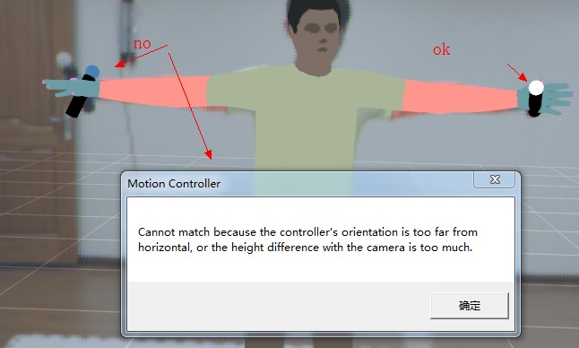

I just aligned with a camera, the moment? No need to press anything?
That's it?
Understand this right?
 Post subject: Re: ps move why?
PostPosted: Tue Jul 02, 2013 8:27 am
Posts: 36
I should follow the body, or the first track PS MOVE?

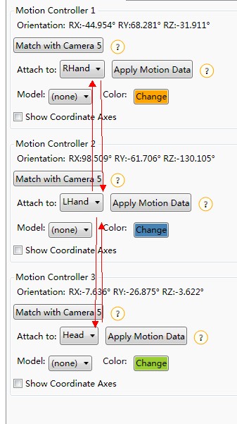

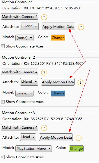

I really calibrated
But it seems that what is missing
It is really very difficult to
I do not know the video camera aligned with what he intended, or what, I align the camera at the "START"
http://www.youtube.com/watch?v=VLp8qw2OBvE

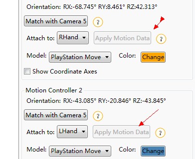

I basically solved the problem, out of a new question
I must follow this order can only be
This sequence is fixed it?
Right
Left
Head
I'll swap positions confusion

PostPosted: Sun Jul 07, 2013 2:30 am
First, you should track the body, so the positions of the motion controllers are known.
Next, you match the controllers with the cameras. For that, navigate to the frame where the actor is aiming at camera (pointing the sphere of PS Move controller towards the camera), select the appropriate camera in toolbar, and press "Match with camera" button.
Finally, you apply the orientation data of the controller to a bone. Attach the controller to an appropriate bone, set region of interest, navigate to a frame within ROI, where the actor bone's orientation is well visible, manually adjust the model bone's orientation, and hit "Apply motion data" button.
Right
Left
Head
The sequence of controllers in "Motion controllers" tab is determined by their order in iPiVideo file, which is determined by how you arrange them in iPi Recorder. You can reorder cameras and controllers in iPi Recorder, at the Setup stage - just drag and drop the screens.

PostPosted: Thu Sep 05, 2013 11:29 pm
Posts: 203
You need to point both your arms at the sensor,
that is the frame where you then press match with camera,
That sets the horizontal orientation,.
Then press apply motion data.
