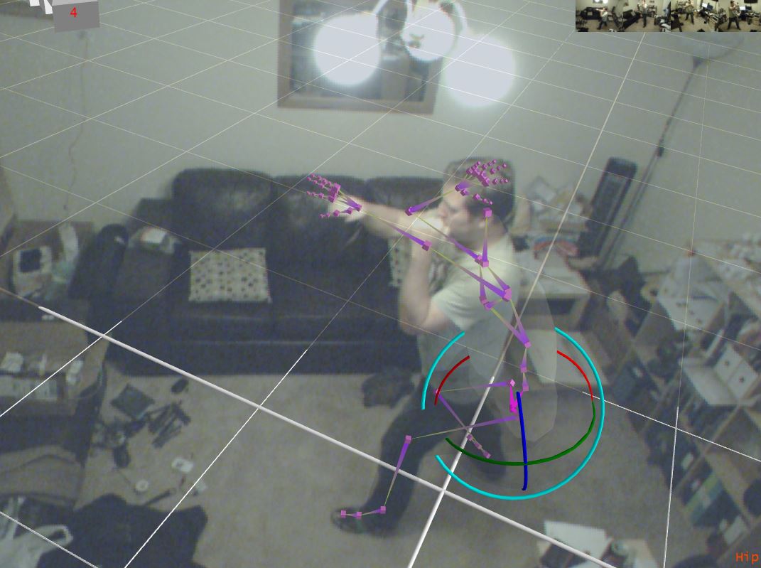

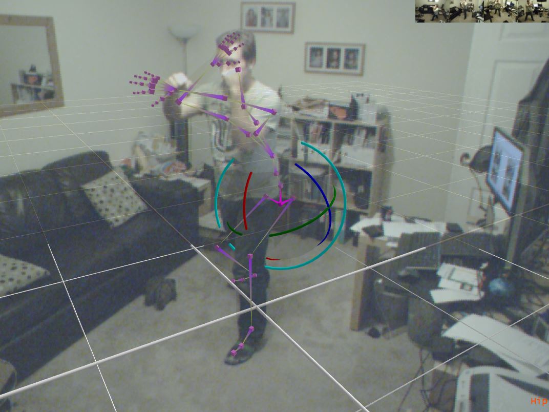

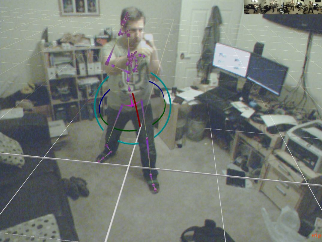

(I have attached 4 images from each camera incase they are of any use?
Look forward to any feedback

As for tracking errors, it's hard to say what's going on without seeing the capture footage. Can you show the volume? Seeing only the bones is not very useful for troubleshooting.
From looking at the stills, the room looks a bit small for PS3 capture. If you don't have a larger space available, you might consider dual Kinect.

I think your manual camera placement is wrong, look at the ipi grid, it doesnt match the shape of the room, before calibrating the cameras, place them manually with the tools you have (pan,orbit,zoom,tilt nad move) , match the grid with the sides of the room and always take the ipi model as a reference, in all cameras, the mesh should be in the middle(doesnt matter if the mesh ddosnt look exactly in the middle for all cameras), then save the scene file so you wont spent time placing the cameras manually again, then unchecked both options "auto detect initial..." and "auto adjust camera FOV" you dont need them, since you already place the cameras manually and when you import the video the FOV was already set, this options are in the calibration tab, then hit calibration, when it finishes, create the ground plane selecting ground points(3 minimum, more is better) then scale the scene with the scale slider and pay attention only to the distance between camera 1 and 2 , the other values, the height values for each cameras, should be set about right while you are setting the distance value right, if there is a little bit to set the height values , play with the "ground height fine tunning" after. these are the steps to follow to get a perfect calibration. NO NEED TO RE-CALIBRATE, ONLY ONCE and after set ground plane,distance between camera 1 and 2 and ground height tunning , you just save the scene xml file which is the one you will use for tracking.
About tracking , you have to use correct clothes, your arms and your torso are clearly blending with the walls. I recommend you to use a black long sleeve t-shirt(although I think your arms can blend with your black furniture and cause problems again) and over that, a green(not dark , not light)t-shirt, then in ipi studio and before tracking the animation, play with camera properties for each cam to make you stand over the background, you should look like a bad photoshop composition, I mean you should look like a layer that just has drop over a background layer and both layer dont match or blend, this way you will have a perfect tracking. Hope this helps.
