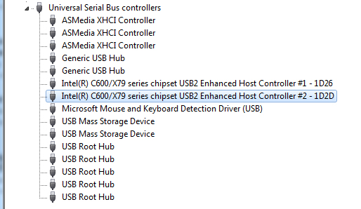

How do I know how many controllers I have? My motherboard is an Asus Sabertooth X79.

From the board specs and this screenshot I suppose you have 2 Intel USB 2.0 controllers and 1 ASMedia USB 3.0 controller.

Will this setup work with 3 Kinect cameras? Does it matters one is USB 3 and two are USB 2? I don't think the ports identify which ones are the enhanced ones, I seem to recall one has to connect the cameras to the enhanced (faster) USB ports right? How would I find out?

"Enhanced" means USB 2.0 in this case. This was to differ from USB 1.0 and 1.1 in the old days. Mixing USB 3.0 and 2.0 ports for connecting Kinects is OK, as Kinect is USB 2.0 device and will work in backward compatibility mode on USB 3.0 controller.
You should connect 2 of Kinects to USB 2.0 ports (black ones) and the last Kinect to USB 3.0 port (blue ones). If you already use our software with 2 Kinects, then you should know the working combination of USB 2.0 ports for connecting 2 Kinects :)
