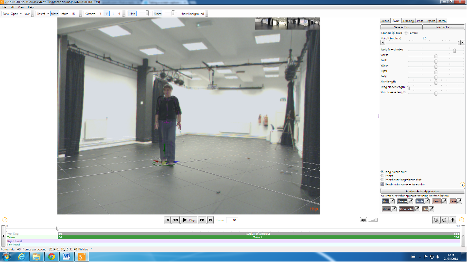

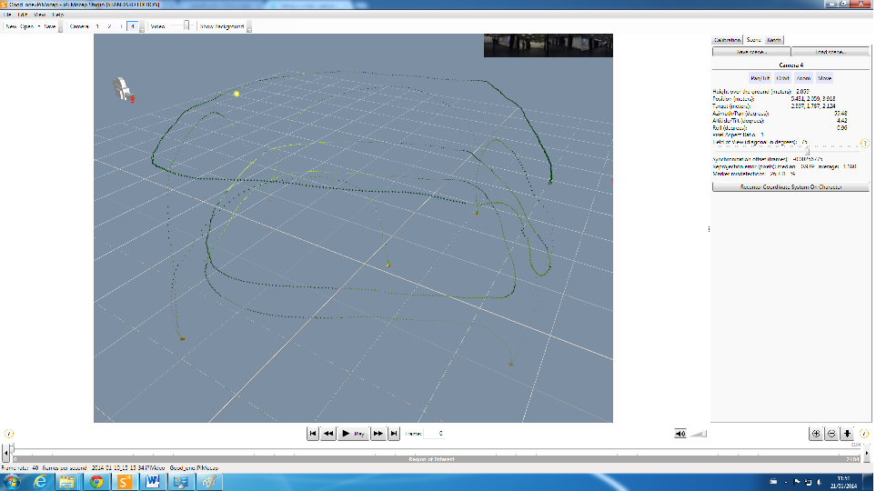

I cannot send message with pictures. I put all the materials here as I found some videos with only myself. As I only can upload two attachments in a post, I show the scene setting in this one and present the tracking result in the next post
The scene setting includes all the camera positions
The calibration result

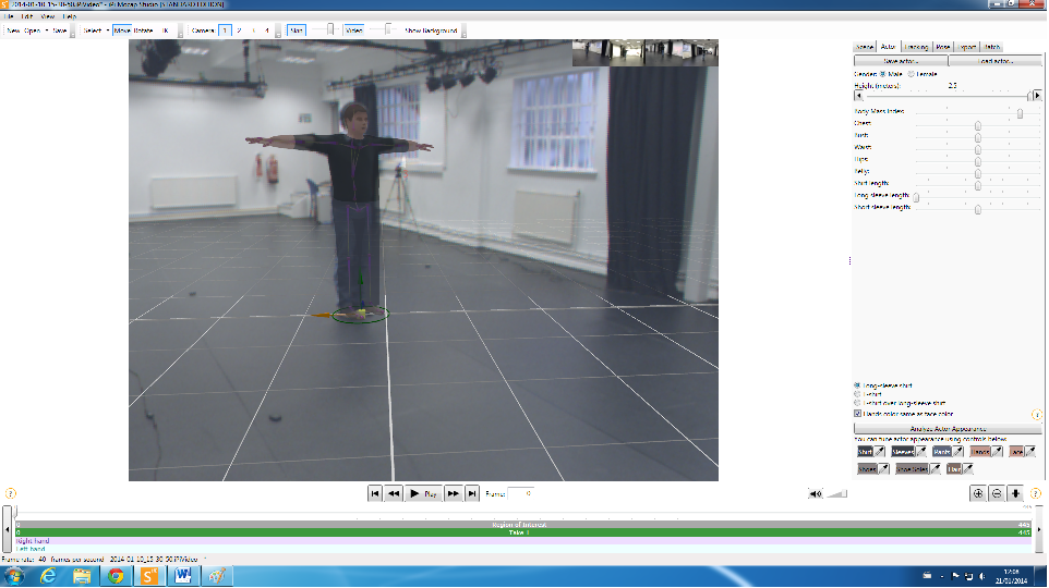

The appearance analysis in progress
The result of the appearance analysis.

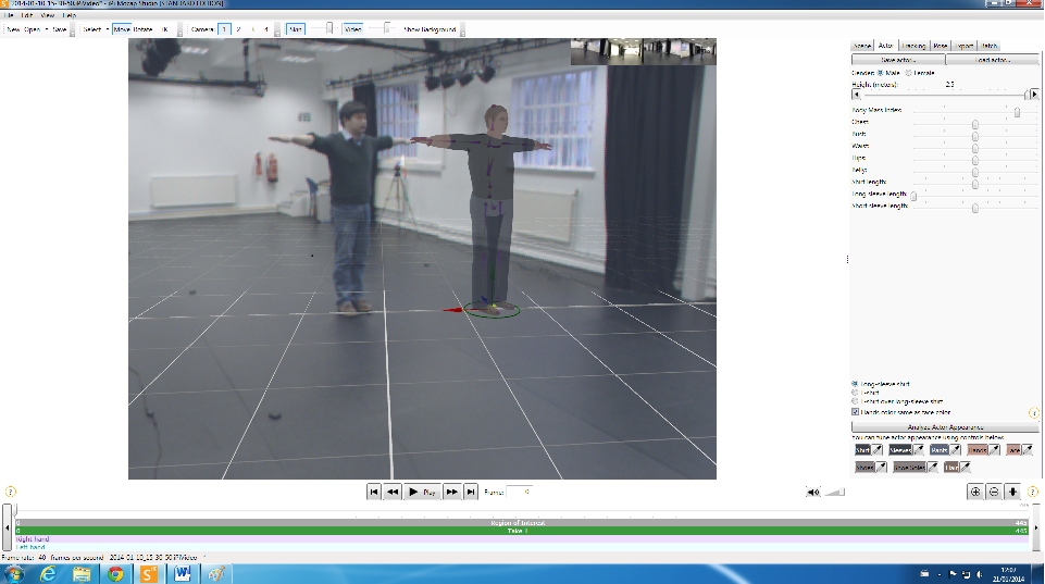

The starting pose

From your attachments the possible problems to me are:
  • Model was not adjusted precisely enough. It is a bit bolder, and colors look not very close. Usually running Refit Pose and Analyze Appearance several times in a loop produces more close results.
  • Some actor's colors may confuse with the background - shirt & curtains, arms and walls.
But it is hard to give you proper directions without the video.
