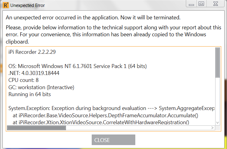

I ve bought lenovo e540 notebook. Ipi soft recorder has detected two cameras. But during setup , frame rates of two cameras arevery low and in evaluation section i m always getting an exception message and application crashes. How can i solve this problem?
File comment: Ipi Soft Error Message

To diagnose the problem, it's better to have the full text of the error. Just Ctrl+V after the crash.
Have you tried all combinations of USB ports for connecting Kinects?
Do you have warning signs (yellow) alongside Kinect devices in Device Manager?
Do you have other drivers for Kinect installed besides MS Kinect SDK?
If you change video mode to "depth only", does this make a difference?
