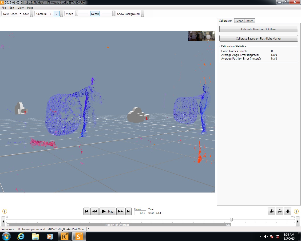

This is the problem I keep running into. The sensors are 180 of one another and approximately the same height. Why, during the calibration, does it show one sensor aimed the opposite direction when it's not?

If you check the calibration statistics, you'll see that the number of "good" frames is zero. That is, the board you were using is not detected at all.
You should use strictly rectangular, thin board with straight, not round corners.

Ah, I see....ok, great! Thank you!

Yep :-) That fixed it. Thanks again :-)
