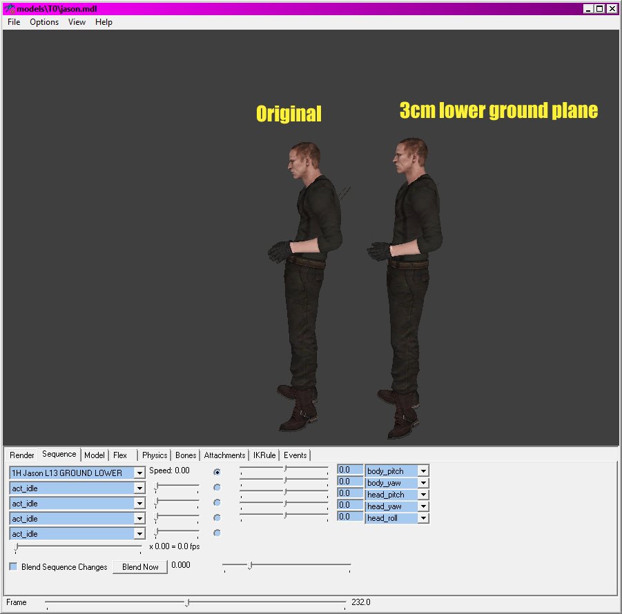

Woohoo! Just making the ground plane lower looks like it fixes the problem :) I'll try it on a few other obvioulsy problematic scenes but as a first test this is obviously better - and it also means I don't have to re-shoot any acting, I just have to reproc the existing footage :)
An excellent fix, thank you very much!
I shall also use a tighter (and longer, to avoid it untucking) shirt from now on as well, anything that can help the capture process.
-Ian

I'm glad that worked for you. How the bones in the rig collide with the performer's shape and the ground plane is a fundamental part of how the system works. We may not be able modify shape the performer's shape to alter the tracking results but being able to lower the ground can relieve some vertical compression on the rig and change how the rig bends.
An even better solution would be to adjust individual body parts of the actor rig to better match the actual proportions of captured performer. We don't have that capability yet but iPi Soft did say they were working on a more configurable actor skeleton for a future release. Hopefully, that' not too far in the future. :)
