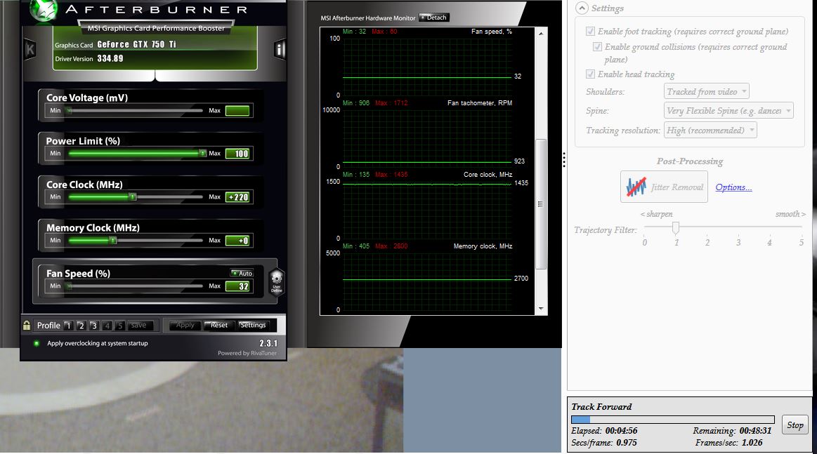

Showing screenshot of the video card and tracking speeds it hit...

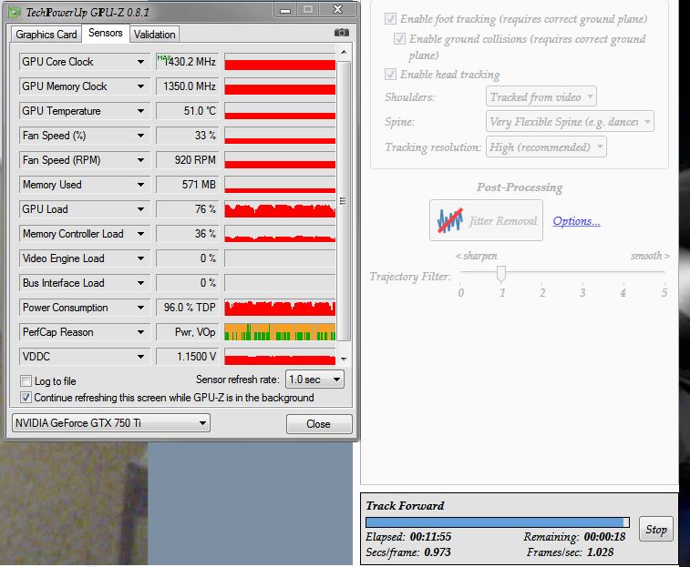

Showing GPU-Z to register highest readings.
This is with a 4 PS Eye set up and 2 Moves used.
750 frame tracking, 1 Studio open, no other programs running (except GPU-Z).
Max on this card running at 1430MHz, I got upto +220 before clipping, but backed off to +215 for this run.
Pretty damn good!
