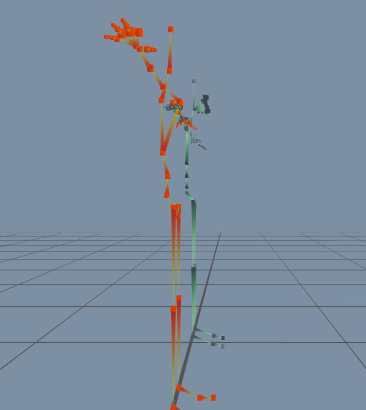

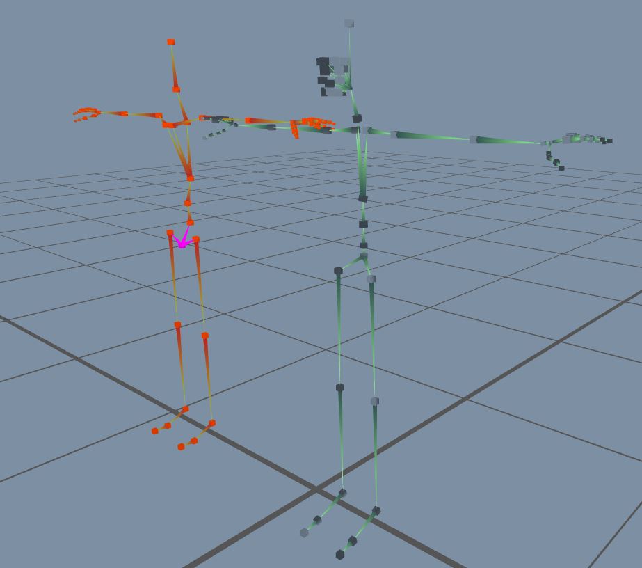

(There is an issue when using pre-rigged custom or auto-rigged or any characters with straight spines, where the iPi skeletons lower spine bone should be more straight, it causes unnecessary belly push, especially on bending actions, as seen in the video, usually needs adjusting in a 3D editor afterwards for better appearance).
Image shows how more common skeletons are created, custom or auto-rigged, it would be nice if iPi could adjust theirs to follow suit for better appearance on most characters on export, hip bone design is not a concern, more the spine hitch and the shoulder bone (clavicle) positioning, but more so the spine hitch IMO, this of course depends on the creator of any skeleton, so it is a catch 22 there also, but most don't hitch the spine in that manner, since skin weighting doesn't depend on bone location/rotation when created, but has effect when using different Mo-Cap files.

File comment: More common skeleton rig

File comment: Most rigged characters, custom or auto-rigged are done this way.
