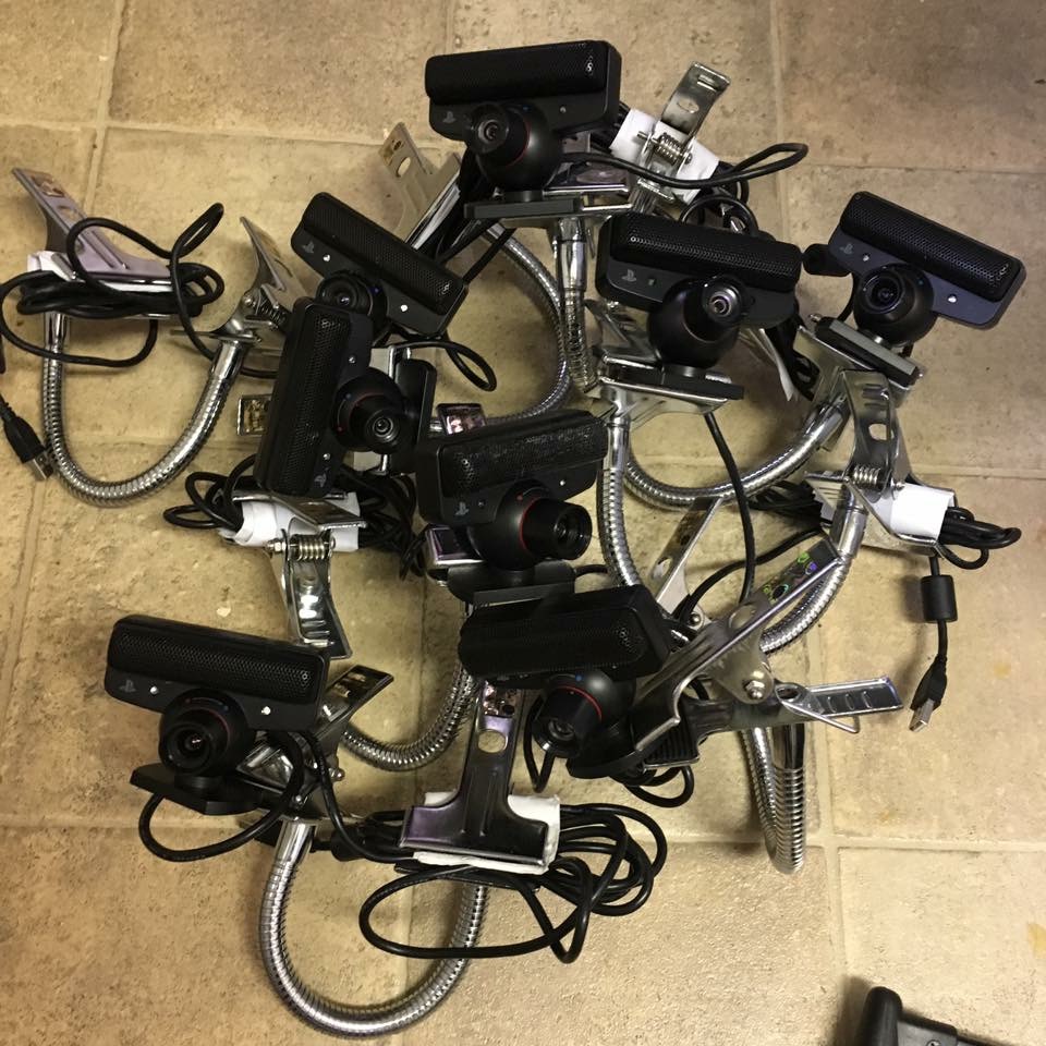

As is, I plan to shoot with 8-10 PS3 cameras.
The space is big enough. It's literally a dancing school so the floor is clear of all obstructions except for an observation couch far away against the wall.
There are no fixtures in this room for attaching anything above the dancers, so while id love to do this, it's just not possible for today's shoot. Not even sure if how that's done was explained in any comments, but I know it was mentioned. I would love this of course but off hand i think I'm gonna need to let it go and hope for the best with a matrix-radius of PS3 cams.
I have 8 light stands
8 gooseneck clamps
2 tripods. Only one with an adjustable neck for added height.
2 pairs of Mocap gloves thanks to Snapz showing me the way (thank you!!)
One is black. One WAS white before I fat sharpied the color to be black...er. I think I feared contrast to the world but to each other may be just enough contrast to allow tracking to be okay enough.
2 GoPro head sets with motion trackers attached.
All motion trackers have been disassembled to their bare bones parts. Again, Snapz taught me this. It's too long for me to explain now but let's just say the result works, is way more compact, and great!

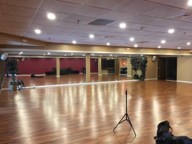

I would like to see how the shiny wood floor and the uncovered wall mirrors work in the tracking process, hopefully if it all works well you will post a processing video and final export video in the forum.
I saw the studio pictures and it doesn't have enough ceiling height for a direct overhead camera(s) anyway, but you could place 2 clipped to the ceiling at highest height possible, this works much better for foot tracking.
Clothing is a big deal with PS Eyes, and flat sole shoes or sock feet work best, although the program will refit to high heels also, if a solid color shoe.
I hope the dancers work with you as far as the best specs needed for good tracking, this helps the most for them to understand the process.

I attached a photo of the space. Plenty of light and room to move around. Clothes I'll have to see how we do.
I will share what I can here:)

I filmed in a similar dance studio environment. If you can, try to cover up those mirrors, at least during calibration.
On my setup, I put the PSEyes to darken, keep the lights on (they are sort of fluorescent tubes, so more area lights instead of point light sources like yours), and block ambient light coming from a window. The problem is that you have your calibration lamp, calibration tracking will have issues trying to figure out which is the brightest light source from the reflections (especially if the calibration lamp is blocked out of sight but the reflection isn't). I also put dark tape on top of every light source, even the PSEyes power indicator. If possible I would keep those head lights to a minimum.
Mirrors are troublesome during calibration, but not so much during tracking, even though there are actors reflection. Mirrors also helps the dancers get their bearings. I tape some markers on the floor to aid the dancers to know where the center is, and what are their boundaries. Waltz is problematic because it moves so much that the actors go off camera constantly. Be sure to activate one mic per recording computer used to record if choreographing to music. It'll make posing of the fingers with respect to music much easier later.

I also can see those mirrors if not covered during calibration could cause issues, but the iPi tracker does do a good job of separating foreground from background reflections, or objects during the performance video tracking.
I also personally would unscrew all direct lights over the capture area and tape white paper over all others, and still have plenty enough light and you can adjust lighting later inside iPi Studio by other means just as easy through the monitors graphics card settings.
Very bright lighting seen by the PS Eyes will turn into very bad results on the video once inside iPi Studio and can easily affect your tracking results.
