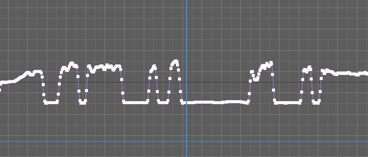

Somehow the tracking result look good when observing visually after jitter tweaking, but when I look at individual bones like the arms etc. they have weird behavior on one axis, in this case the Z-axis.
This does not happen if I just export an unfiltered file.
The reason I want to remove jitter in IPI instead of Blender (in this case), is because removing jitter on a parent bone when the child bone is already good, the child bone will get jittery after parent bone cleanup. #frustrating
Another weird thing is that usually on one side of the body it is the top of the jittery curve that is correct, and on the other side it is the bottom.
Is this just a "noob" problem?

Kind of hard to see from just an F-Curve snapshot what the actual appearance is, is it possible to use a screen recorder and upload the video to YouTube, or similar service, then post the link here?

The problem happens on every recording and stays within IPI beofre export and is not related to Blender (Blender only shows the curves). The Z-axis shown above is the axis that run along the upper arm bone on both sides. The forearms can also have this problem, but less so.
In the curve snapshot you can see that the lower segments are flat, means these are the problem areas and they lack tracking data.

I am retty sure there is something wrong with the JR algorithm as it creates "dips" in the data along with the smoothing. But haven't anyone else encountered this?
