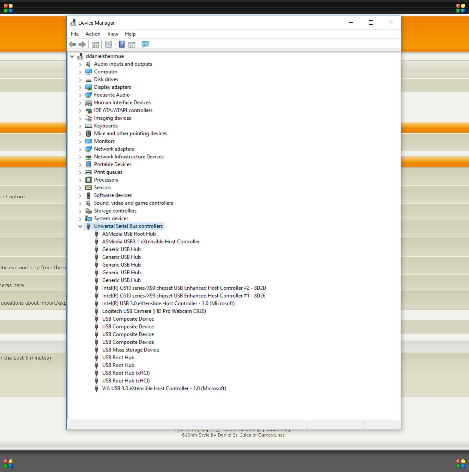

can anyone tell me how many ps3 cams i can hook up based on my USB controllers?

It looks like you've got an Intel combined USB 2.0/3.0 controller, and also 2 more USB 3.0 controllers (ASMedia and VIA).
Intel should handle 4 PS Eyes, and each of additional USB 3.0 controllers may handle 2 PS Eyes unless compatibility issues arise. For instance, PS Eye have known issues with VIA VL800 USB 3.0 chipset.
So in total it's 4 to 8 cameras (at 60 fps) depending on USB compatibility. Also you can get more at lower FPS (30-50).
