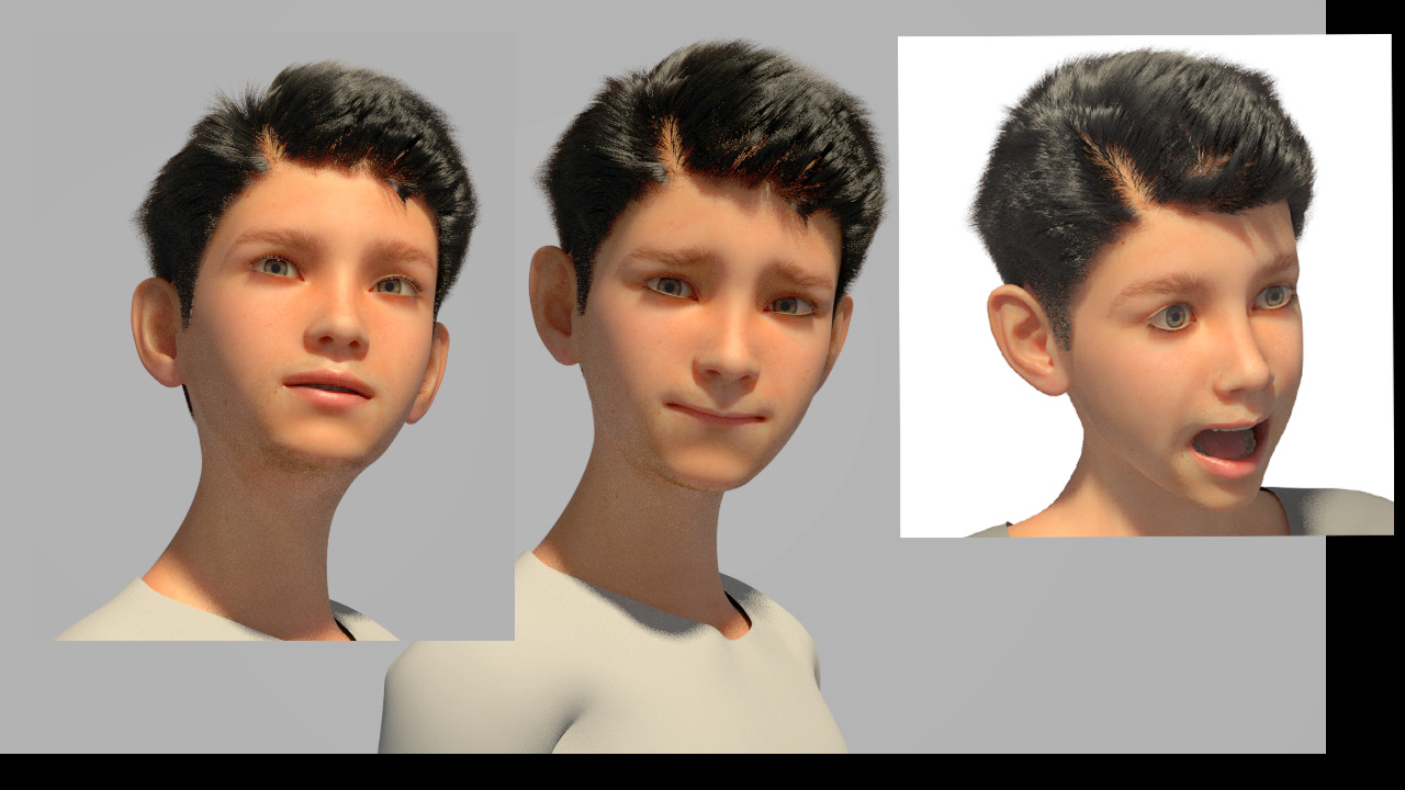

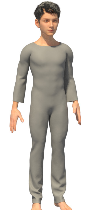

xgen hair can be applied to it as well, here's a sample of a youngmans character made from the default genesis model and a simple jump suit created in MD and applied with wrap deformer (no weight painting).
you can also see some expressions that are from Daz facial morphs.
contact me if you need more detailed explanations.
