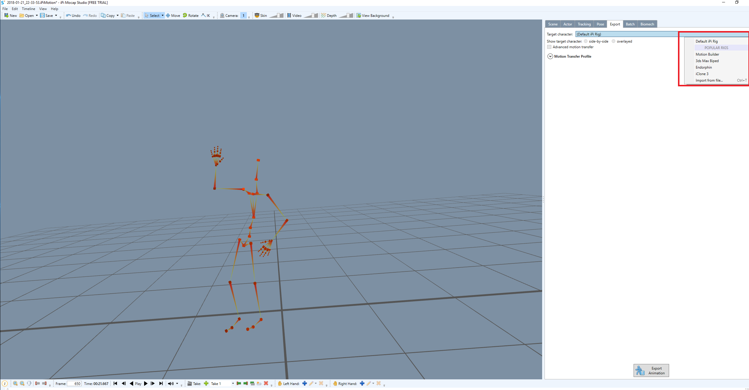

Please help to understand!
I do not see the export to the program Blender (please see a screen)
What it is necessary to make that export to the BLENDER has appeared?
PostPosted: Mon Jan 22, 2018 7:01 am
There is no preset for Blender in current version of the software. It was mostly needed for compatibility with older versions of Blender.
If your scene in Blender is Z-up and you experience problems importing animation from iPi Mocap Studio (which is Y-up) then I could suggest you the following.
  1. Import your character from Blender to iPi Mocap Studio as a target character.
  2. Setup necessary rotations of axes for it so it's properly aligned in Mocap Studio.
  3. Setup retargeting bone map if it's not filled automatically.
  4. Export animation.
Resulting animation will be retargeted onto your character and will have the same orientation of axes.
