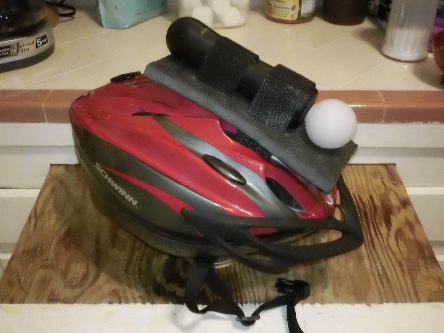

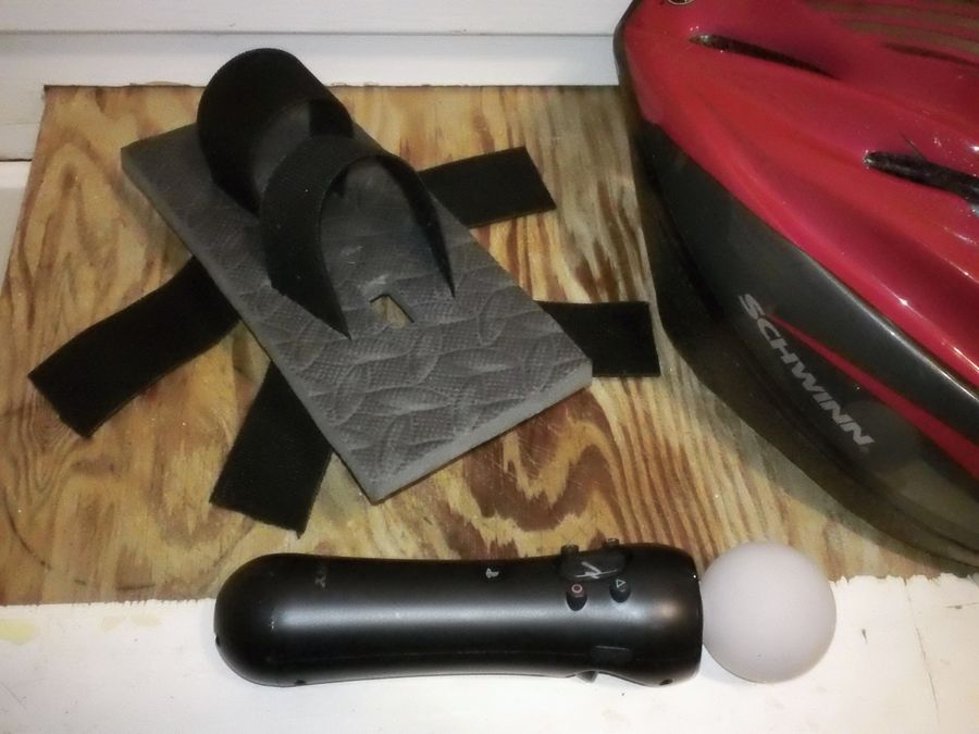

Inspired by Jomário's setup, I assembled a head rig tonight using my bicyle helmet. Here are some pics.
It actually came together nicely--The velcro straps fit into the slots in the helmet and I cut a hole in the foam to keep the PS Move's trigger from being pressed. The device sits very firmly on top of the helmet. But I'm not sure I can recommend this rig because:
1. To keep the helmet fixed firmly to the head I need to tighten the strap under the neck, which isn't very comfortable for me. I'd much rather have a helmet with an actual chin strap.
2. A bike helmet is too expensive for this purpose and I want to keep using this one as a bike helmet.
This rig should get me started for testing anyway. I should be receiving the skateboard helmet in a couple of days but I still want to find the hardhat suspension like the one Jomário is using or another good alternative.

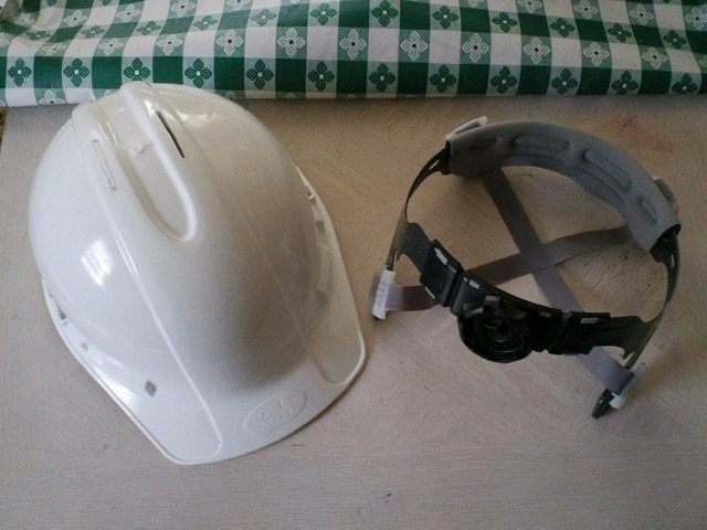

So here's what I wound up using: a hardhat made by 3M, purchased from Home Depot for about 9 dollars. Make sure you get the kind with a ratchet suspension. Tip: the white helmet is a few dollars cheaper than the yellow one.

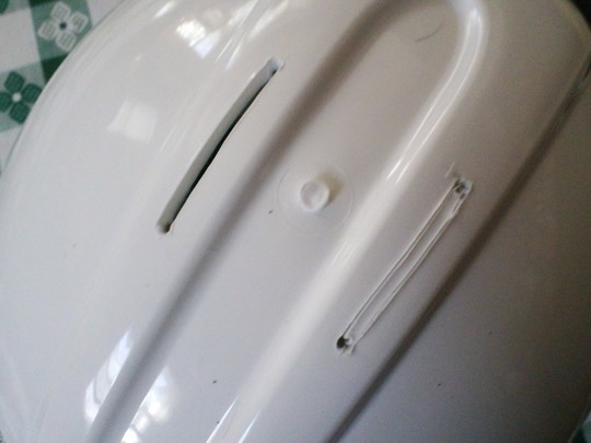

First, I drilled four holes in the top. The holes are spaced to slightly over the 1 1/2 inch width of the Velcro One-Wrap strap described by Jomário in his original post. Then I used a utility knife and a metal straight edge to lightly score the edges of the slots I want to cut out. Do this gently and carefully so as not to damage the helmet or, more importantly, cut yourself. Once you have the lines scored, carefully go over the lines over and over again, using only slight pressure, until the knife cuts clean through the helmet. I cannot stress how careful you must be--these knives are very sharp.

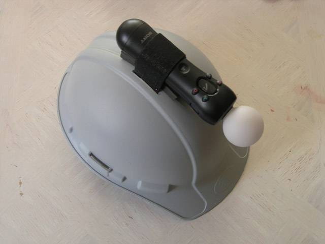

Here's the helmet assembled.
Under the PS Move is a small piece of foam rubber. It's long enough to support the base, and short enough not to interfere with the trigger switch. Later tonight, I'm going to glue this pad to the helmet using E-6000 or some kind of contact cement.
You may have noticed that helmet has been painted with gray primer--this is because the original plastic surface is very shiny and reflective. The paint can actually be any color except black and the key is that it needs to have a flat or matte finish. Here are the reasons for painting the helmet: if you're recording with Kinect, shiny reflective surfaces will reflect the IR rays and you want to avoid black because it may absorb IR rays; if you're recording with PS3 Eye cameras, the reflective surface may confuse the tracking system.
As is, this rig is very stable so long as I'm not jumping up and down. The one thing I'd like to add is a chin strap, which should solve this issue. There are loops on either side of the helmet, so it should be very easy to add a strap.
