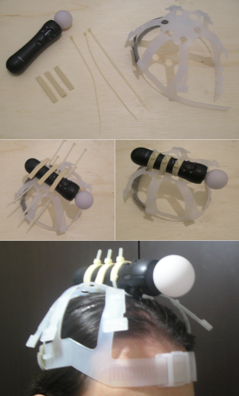

Hi, some people asked me to try to find another way to hold the controller
because they are having problems on attaching the ps move with their headsets.
I borrowed a ps move and use some things I already had here and made this prototype,
I tested and it's very stable.
You'll need:
- Internal part of a hard hat (it's called "Suspension", it's sold separately and it's very cheap).
I recomend buy the chinstrap too. (I didn't have any to use with this example)
- 3 plastic strips (I used: 25cm x 4mm ( 9.8in x 0.2in), but it could be in any similar size).
- A small piece of EVA (Ethylene vinyl acetate) or something similar.
(it's just to avoid the strips to scratch the controller) (cut 3 pieces with 1cm x 8cm (0.4in x 3.1in))
*To increase the balance, the controller should be placed pointing back.
(anyway you can use the suspension inverted, it's still comfortable)
*Don't pull the middle strip too much or it will deform the suspension.
See attached image for details.
Hope it helps.
Jomário Murta

Sorry about the delay Greenlaw,
this kind of suspension is very easy to find here, in any safety store,
it's like a standard in Brazil (I think even worldwide, these hard hats
(or construction helmets) are very similar).
But if you can't find it separately, even the hard hat is very cheap,
you can buy one and remove the suspension.
I think the problem with the bicycle helmet is about the weight, you'll
need to keep the chinstrap very tight, it could become uncomfortable
during the recording. With the suspension model you'll need the chinstrap
only for very strong movements or when looking down (extremely).
Hope it helps.
Jomário Murta
