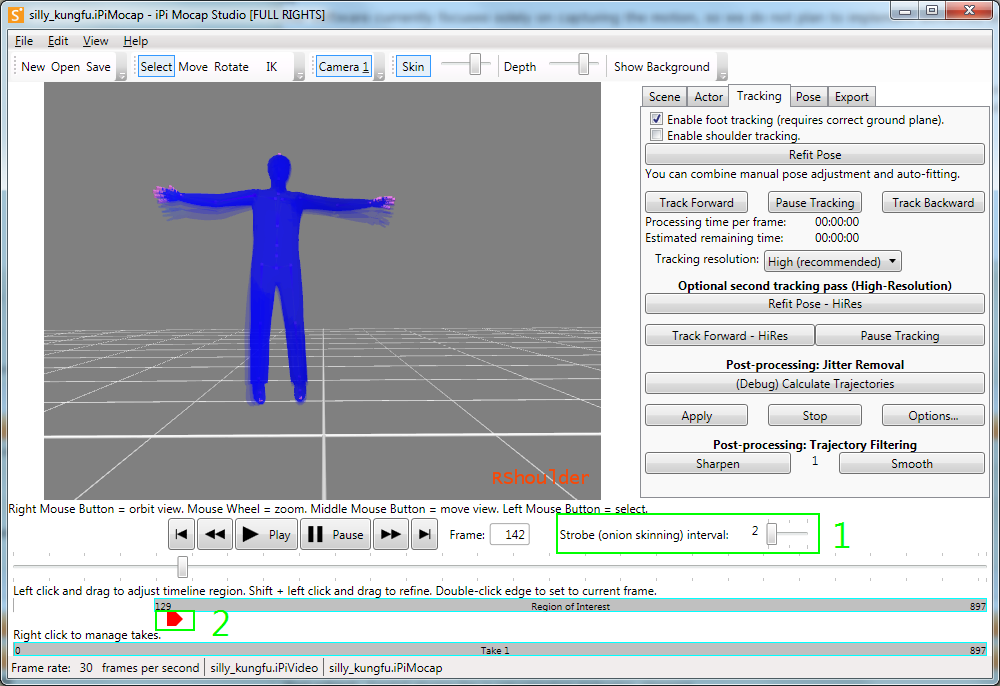

Our software currently focuses solely on capturing the motion, so we do not plan to implement advanced animation editing features. You can do this after exporting animation to an animation editor of your choice.
curly wrote:
1) Animation ghosting or onionskinning of the bones
Studio already has this function (see attached image). This works both for skin and bones.
  1. Set "ghost" frames interval interval (which one frame to display as "ghost")
  2. Set onion skinning duration
  3. Enable onion skinning by checking the View > Skeleton Strobe (Onion Skinning) menu item.

File comment: Onion skinning example
