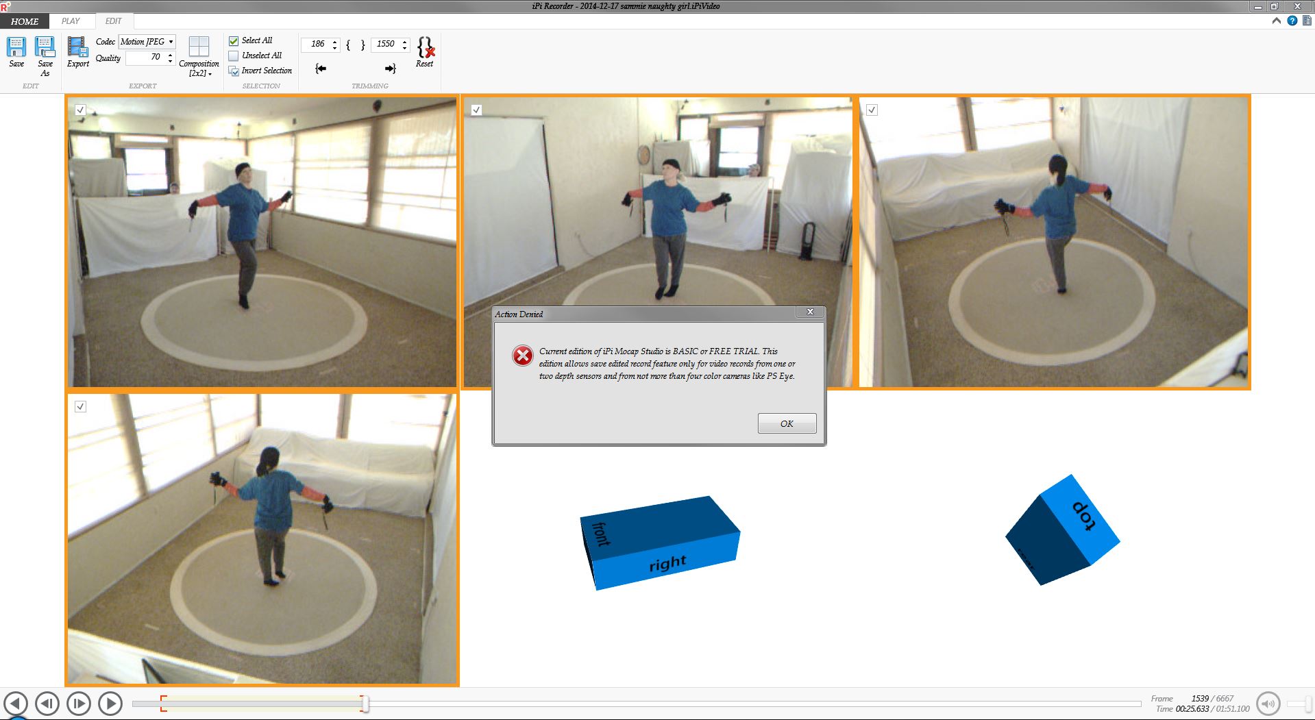

I tried to edit a portion of a recoding to a specific time frame and got this error shown on attached file.
I am using only 4 PS Eyes and 2 PS Moves.
Why can't I resave edited time of video?
PostPosted: Sun Dec 21, 2014 11:19 am
The edit feature in iPi Recorder requires an activated license for Mocap Studio on the same PC.
In this case, looks like the program incorrectly determines whether the video can be edited with the current license. We'll check that and fix in the next update of Recorder. Sorry for inconvenience and thanks for reporting.
