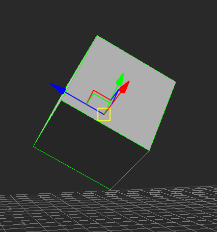

2. Global/Local Axis : Please find attached picture of what I mean:
[img]local.PNG[/img] [img]Global.PNG[/img]
This will help setting up things accurately and faster. We have this function in other 3d products.

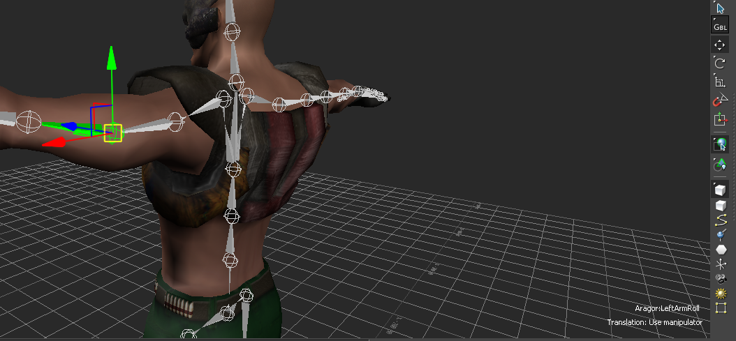

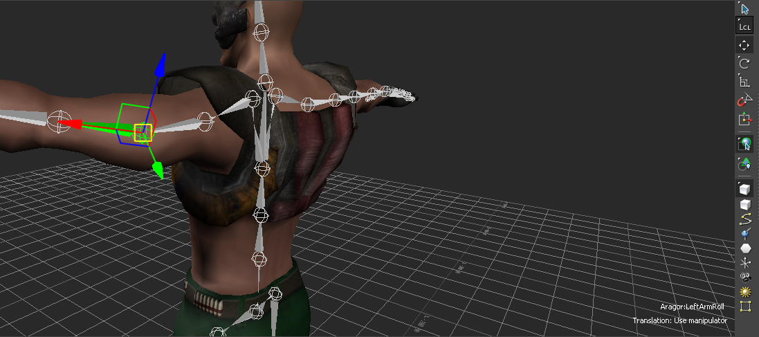

My point was to have Local/Global axis option for individual bones of a actor. Just like how in Motionbuilder, We can move/rotate a joint in Local/global axis. What I am asking for is switch for changing local move axis to global move axis. This is small feature but is very useful.
I have attached pictures of same.
[img]localaxis.PNG[/img]
[img]Globalaxis.PNG[/img]
