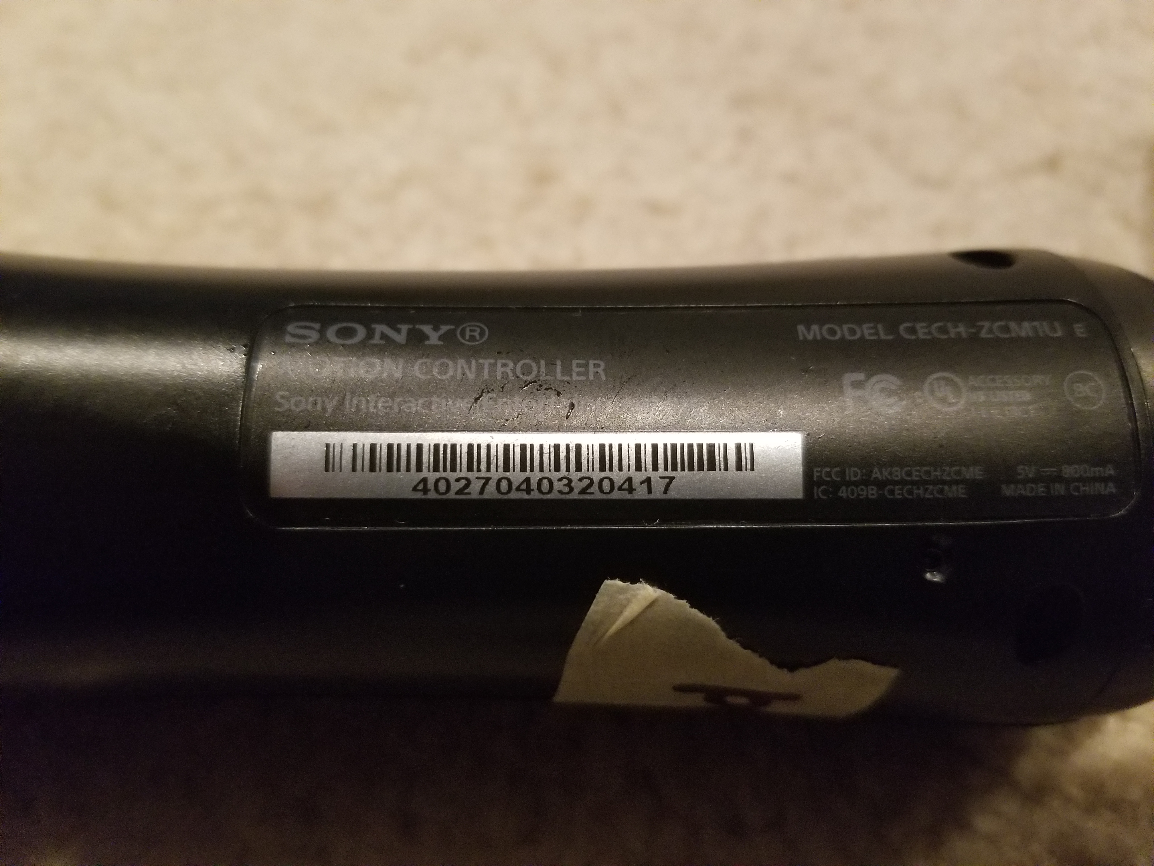

I'm having same problem connecting my PS Move to ipiRecorder on Windows 10.0.18362.0 any solutions?
Would using a USB to Bluetooth 2.1 adapter work around this problem??
My PS Move info:
