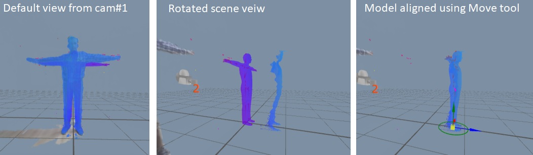

Please check that actor model is actually aligned with point cloud (roughly) by rotating the scene and viewing from different angles. Sometimes it looks aligned in 2 dimensions, but is not aligned in 3rd dimension. Please refer to the attached screenshot.
If you still experience the issue, please record screencast of your actions in order we could track down the problem.
