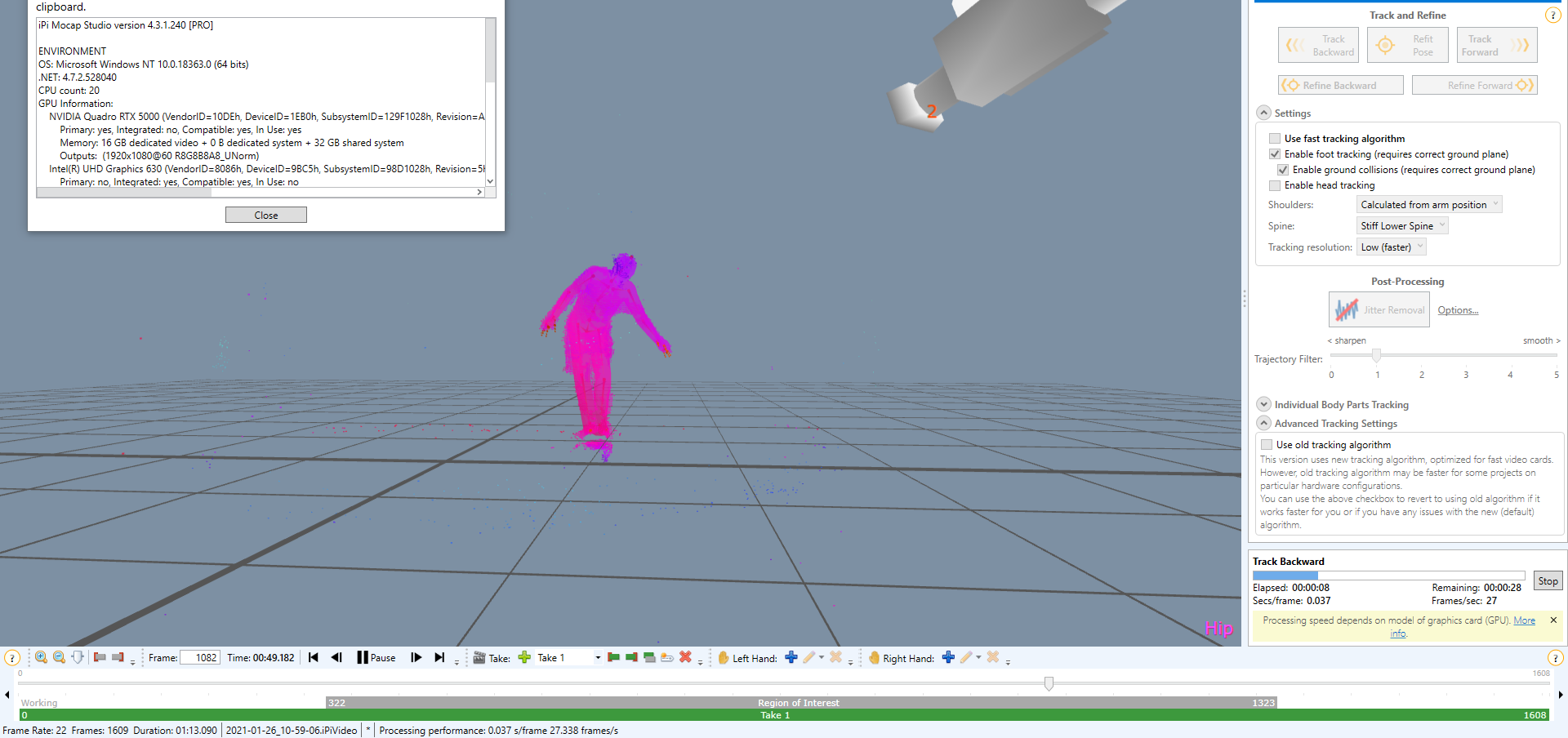

It just crashed while tracking resolution was on low too.
Concerning.
Error_7 (low resolution tracking, with maximum power setting).png [ 251.63 KiB | Viewed 44686 times ]

It does not crash when I use 'Old tracking algorithm' under 'Advanced Tracking Settings'.
Is this the same quality? Does it lower the accuracy? It seems to be very similar.
PostPosted: Fri Jan 29, 2021 1:49 am
Posts: 203
yes, the quality and accuracy are the same.
Old algorithm uses GPU less intensively, so this may hint that there are some hardware issues under high GPU load.
There may be not enough power or card is overheating.
You can try using GPU-Z to monitor card temperature and compare workloads for different options.
