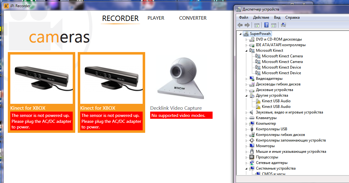

Aktion wrote:
Still got same issue with SDK 1.5 (removed any primesense/openNI drivers) - Kinects detected but This sensor is powered up. They are powered, moreover, worked perfectly 15 mins ago with PrimeSense drivers.
Can you please provide us a screenshot of how Kinects are looking in Device Manager when using Kinect SDK drivers?

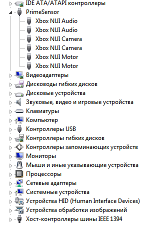

File comment: This is uninstalled everything with openni/kinect and installed Microsoft SDK 1.5

File comment: This is using Prime Sense driver from v1.3

2Aktion:
Today got the same "not powered" issue from once more customer by email. Later he wrote that they've bought another Kinect, and it works fine. So maybe it is some hardware problem in specific instances of Kinect. It is strange that it is also computer-dependant, as you say your Kinects work fine connected to laptop.
Anyway, your Device Manager screenshot definitely shows that there is some problem between your devices and Kinect SDK drivers. Instead of "Microsoft Kinect Audio Array Control" devices under "Microsoft Kinect" node there are "Kinect USB Audio" devices under "Other devices" node. You can find the "correct" picture in Device Manager on this page.
Also, here there is a sequence of connecting Kinect to PC:
    1. Connect the power supply for your Kinect to an external power source.
    2. Connect the Kinect to a USB port on your PC and wait for Windows to recognize it.
    3. All the drivers, including audio, will load seamlessly.
I think, order of steps 1 and 2 can make a difference.
