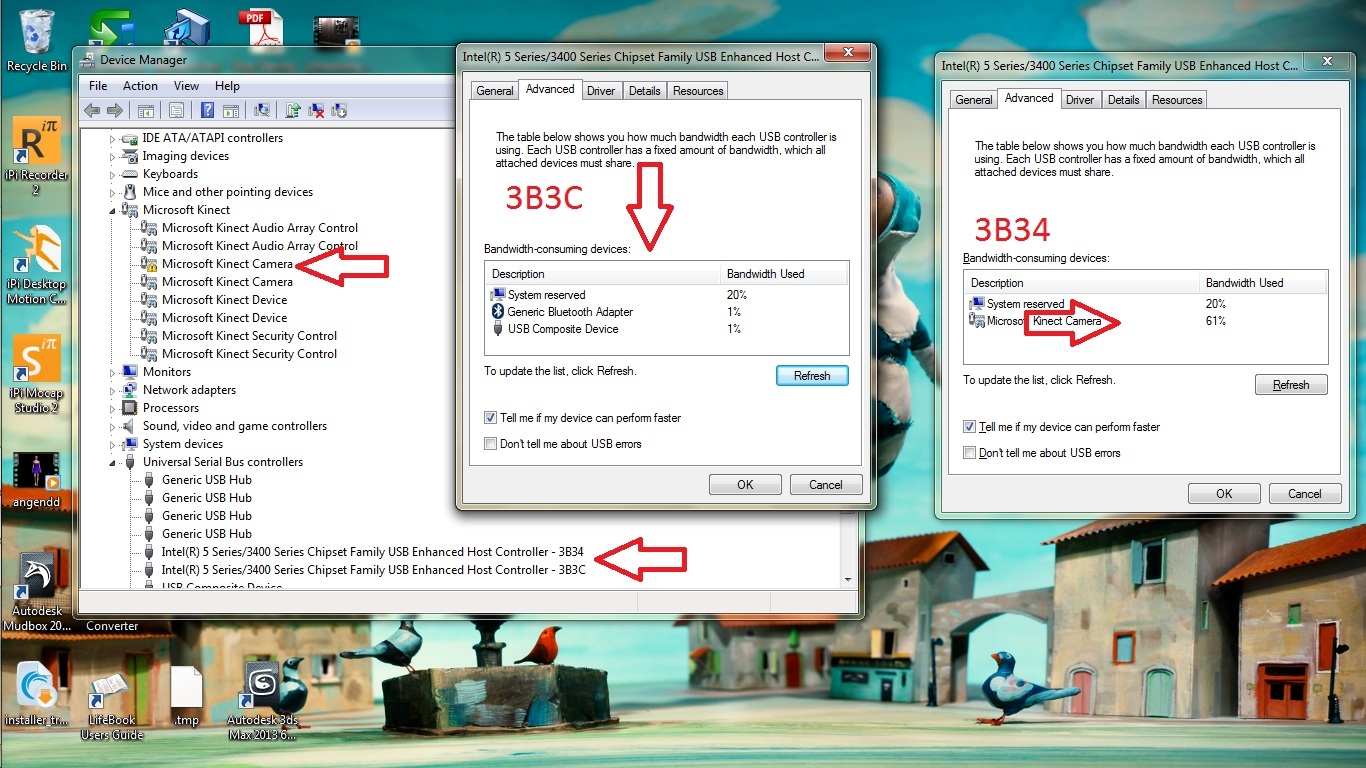

1.is there a way that i can install a new usb port into my laptop without change mother boards
(reason why is I have the same setup shown in the user guide[img]
2. How do i find out if a usb express controller capable of driving a bandwidth type device for what i have looked at they dont say

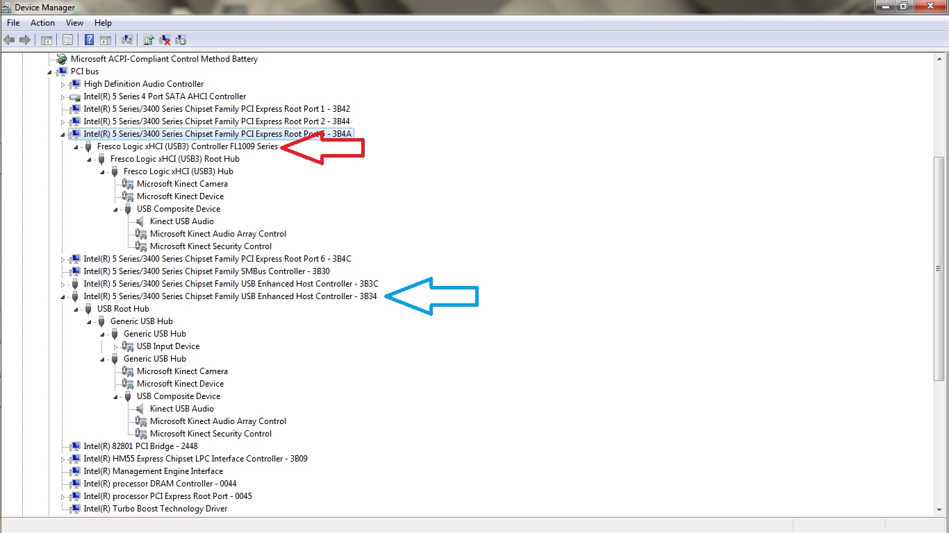

Is this picture of situation when you connect both Kinects to laptops's USB ports, or when one of them is connected to J-Tech card?
I suppose first, because J-Tech should display as not Intel USB controller, but some other's vendor controller. So can you attach a picture of second case, with power cord attached to J-Tech card? And good to switch Device Manager to the Devices By Connection view (menu View > Devices By Connection).

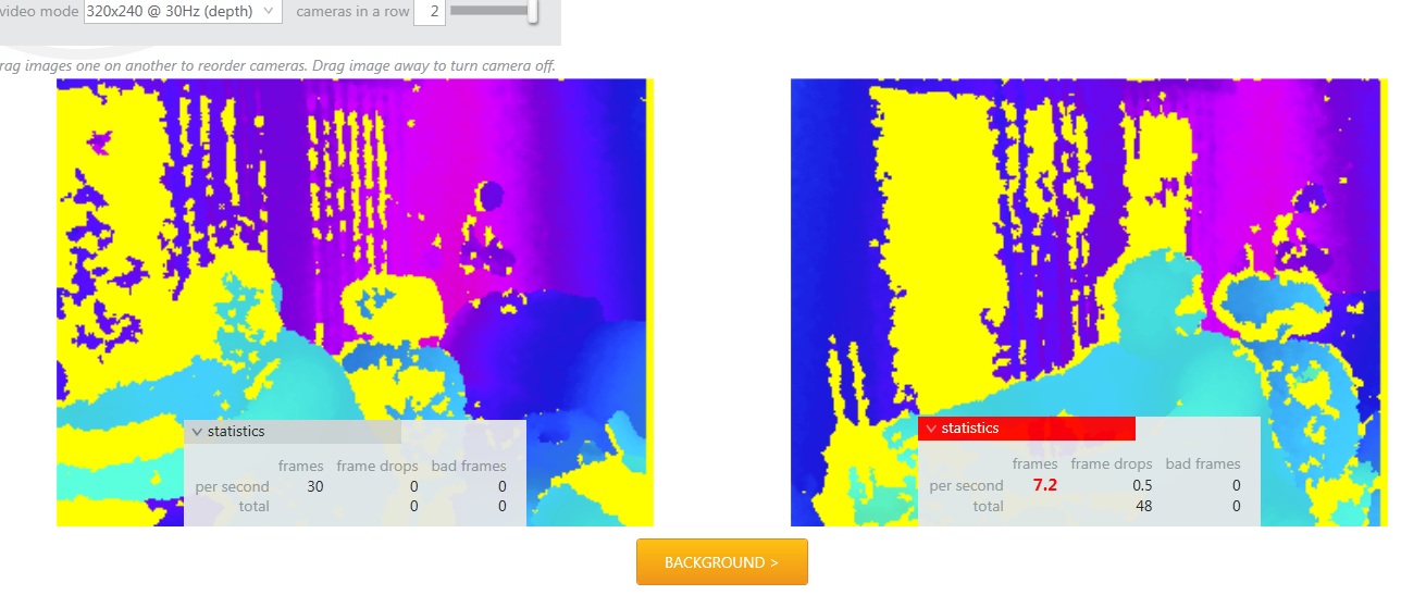

The 1st picture was just the just the normal plug in. This new picture is with the J-card plugged in but there is no Advance tab to click to check the BW so i dont know how much power is being used. I have the power cord plugged in for the J-card aswell. And it works but the new problem is that it loses frames after 10-20 seconds. It goes from 30 frames to 8-10 frames after, i have changed the video mode in the recorder 640*480 to 320*240 depth veiw only and it still drops and stays low frames with 8-10 drop frames. Left in that mode with no movement in the cameras view it still stays low and never goes back up..its it possible that the J-card is faulty because it seems lke its loseing power if the frames are dropping a few moments.

Maybe indeed some USB compatibility issue :(
What if you plug just one Kinect to J-Tech card, will it show the same low frame rate values?

Yes plugging 1 Kinect into the J-Tech card is just as bad frame rates drop faster by itself..the odd thing is when i plug in the J-Tech card there are three chimes two make the sound of a device being plugged in and the last makes the sound of a device being unplugged I am not sure why.
